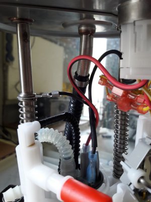

PROBLEM SOLVED!!!!
Thanks to this youtube video
Pumps arent faulty, nor the model year matters.
Bosch, and others, in their infinite wisdom decided to add an extra permanent ground to the pump motor. So its at full blast all the time. Why? Its beyond me.
Snipped the ground, put the 07 one in and all is well.
Ps, it threw code P0191 before
