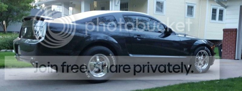

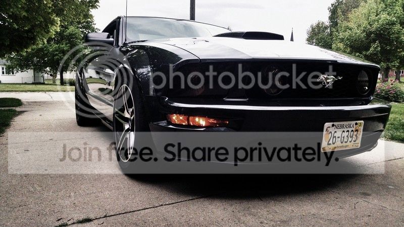

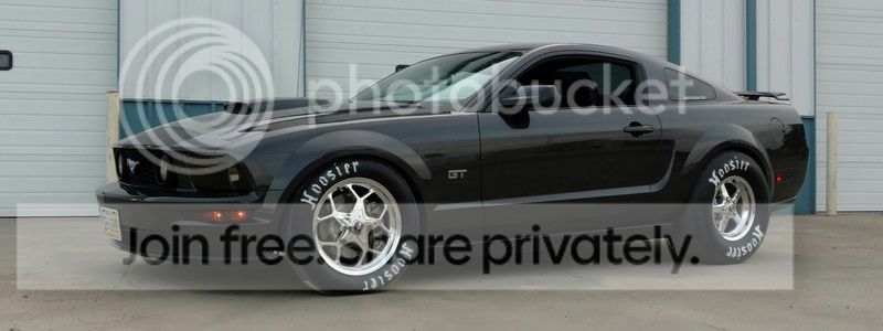

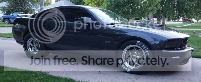

I wanted to go with the 94 series in the front and 92 in the rear. I think it looks cool and a little different from everything else.
weather man
Persistence Is A Bitch
Mar 3, 2012
13,340
161
MN
Well, if I squint my eyes, cock my head to the side and squat down a little, I can kinda sorta almost see what your trying for :goofy_batman:
If you like it, all good. :clap:

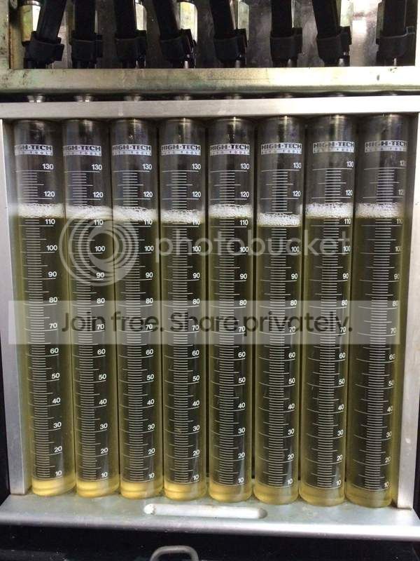

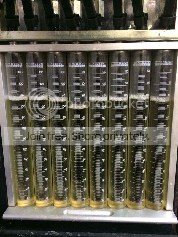

Small update on the car. I sent the ID1300 injectors out to LSXkiler Custom Calibrations to be cleaned and flow tested. He flowed them before and after cleaning. The injectors are now flowing within 3% and as you can see they picked up flow across the board. Waiting for them to show back up in the mail so I can get them installed and get some new logs done. Hopefully we will be ready for 30lbs soon
Before
After
