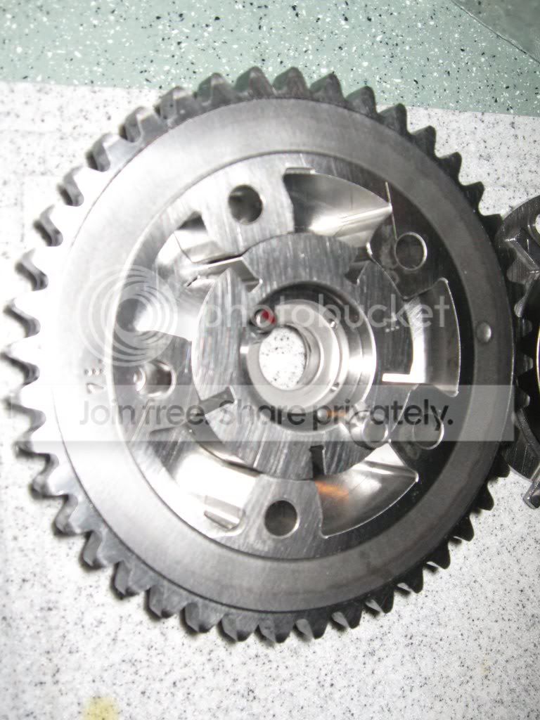

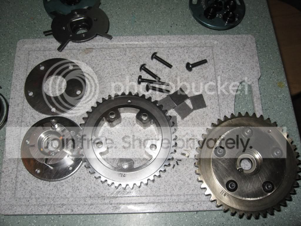

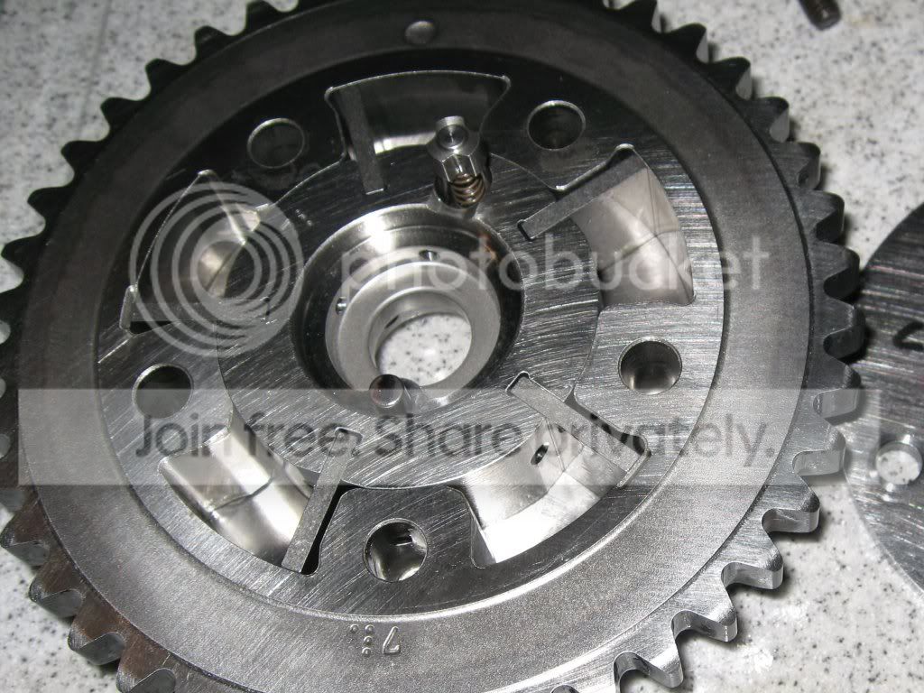

All the parts...

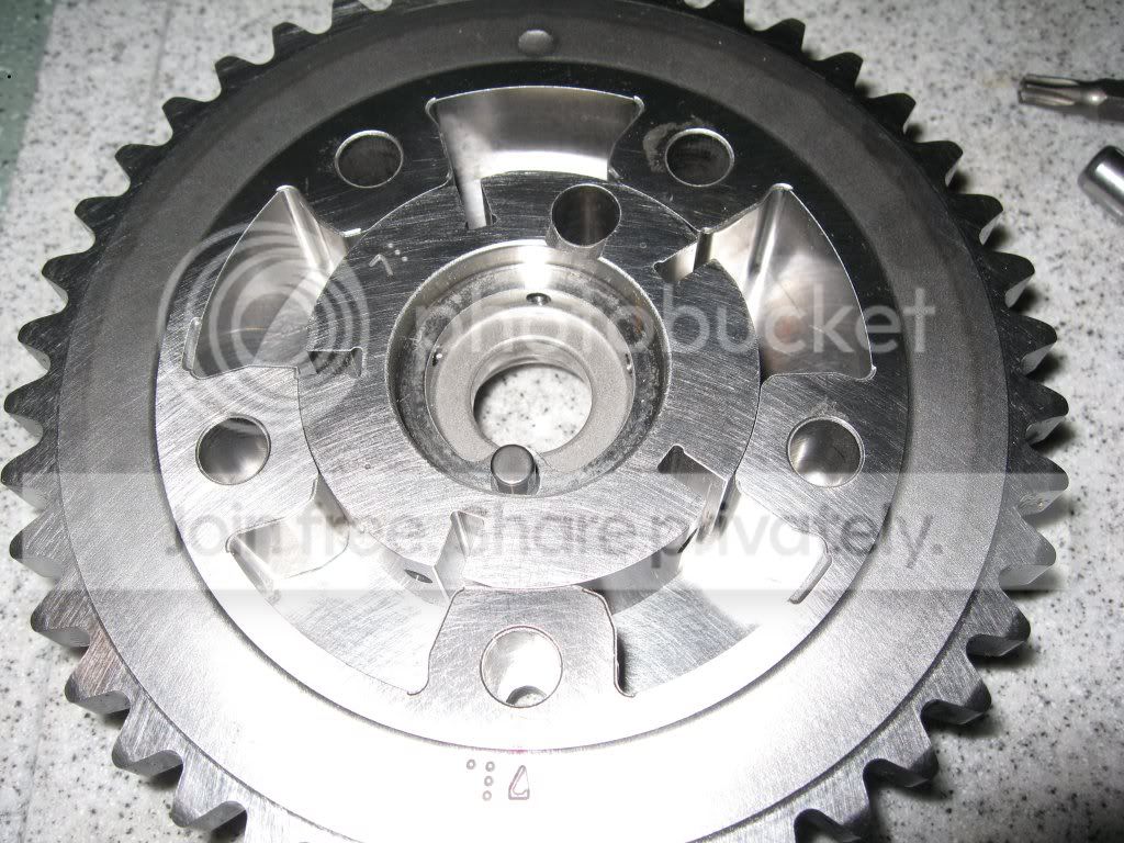

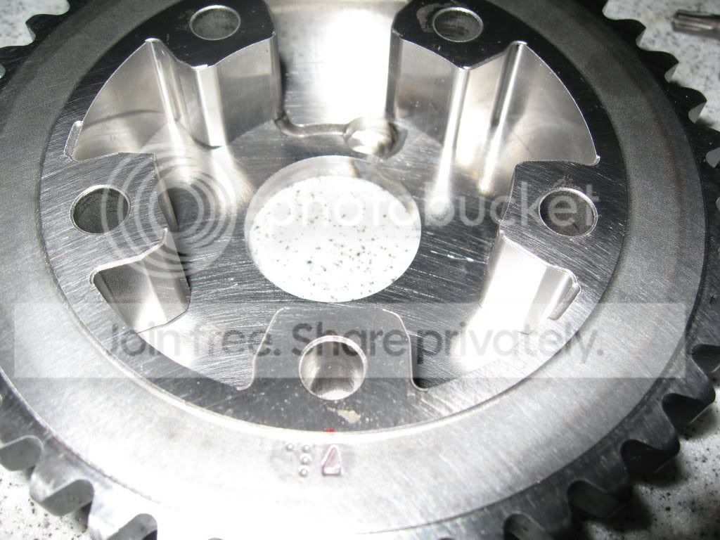

The base - note the "oil groove" orientation - that is where the bottom of the little oil metering spring goes in a few steps
The "gear" on the base - note the orientation - use the little mark at the bottom (upside down "7" and dots on the gear at the bottom) to keep things lined up
The inner wheel (this is the wheel that is fixed to the cam - the "gear" rotates independent of the cam - this wheel inside the gear is fixed and is used to control the angle between the cam and the gear... )

Bottom "cup" of oil metering spring
The "spring" itself goes in the cup
Oil metering "thingy" (that's a techincal term)

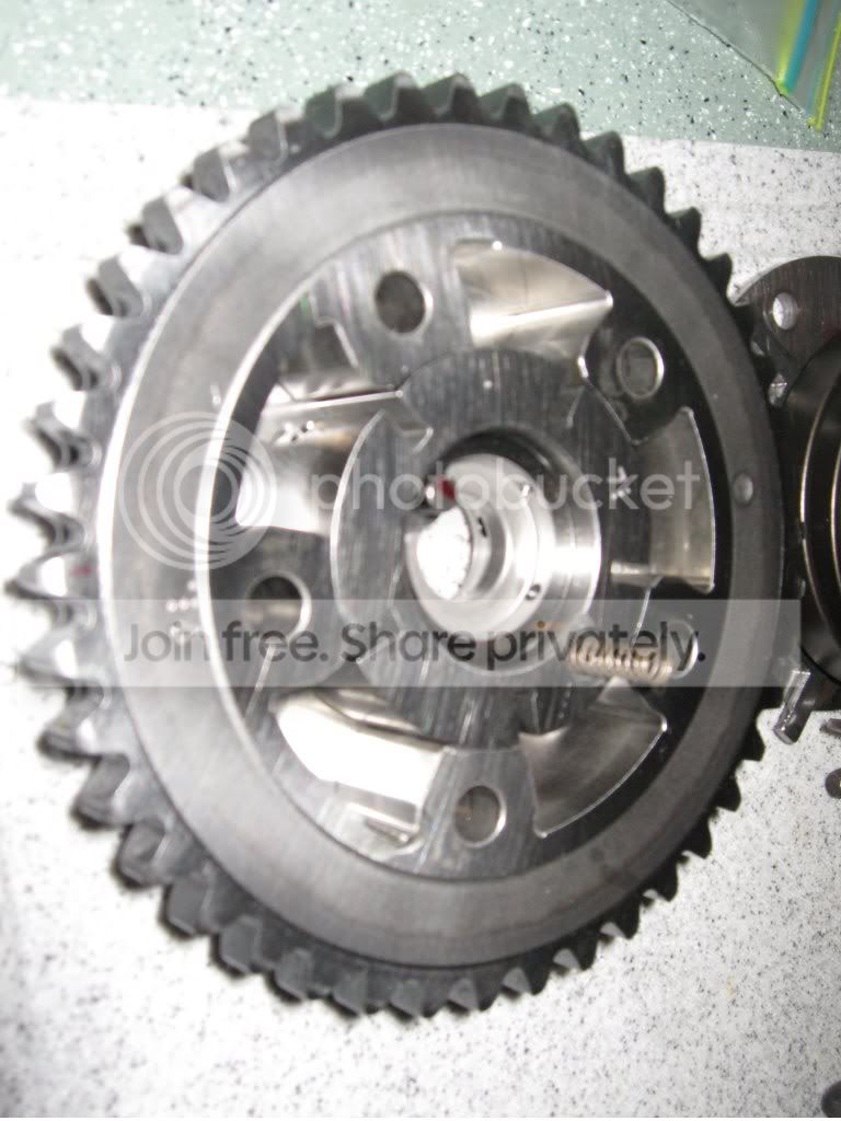

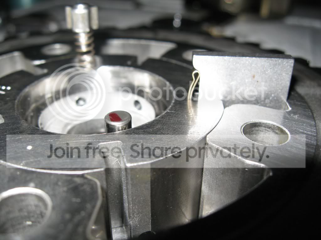

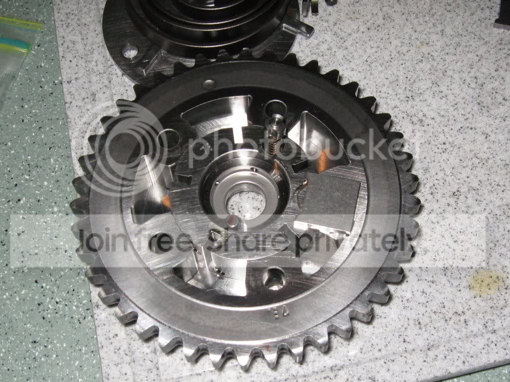

The "flap" against which oil pressure is applied to rotate the cam relative to the "gear"... Note the tiny little spring that goes inbetween the flap and the wheel...
Note the orientation/placement of the little spring - doubt it matters, but this is the "stock" orientation...

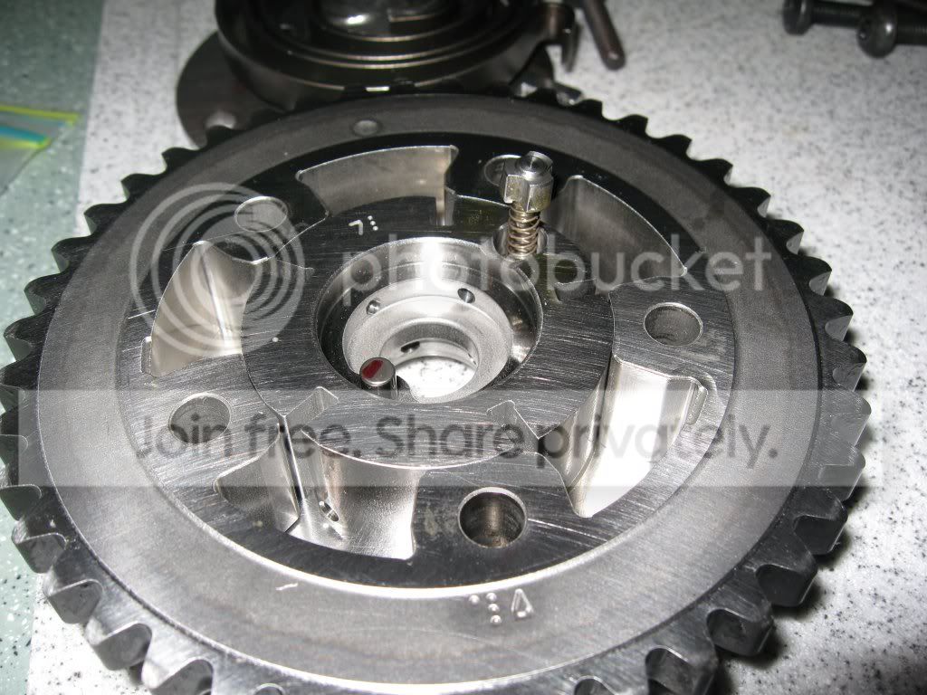

All the "flaps" now back in, roughly in the "full advance" position that the spring will hold the phaser in before the car is started...

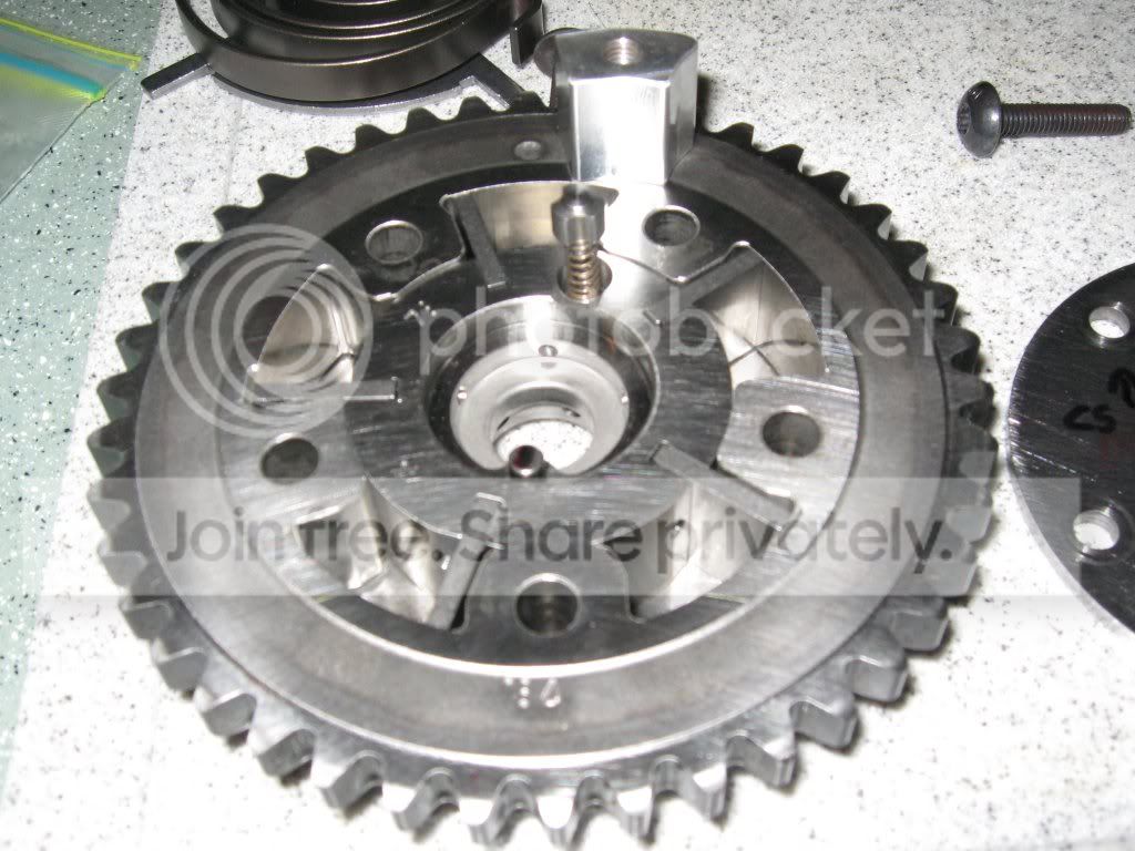

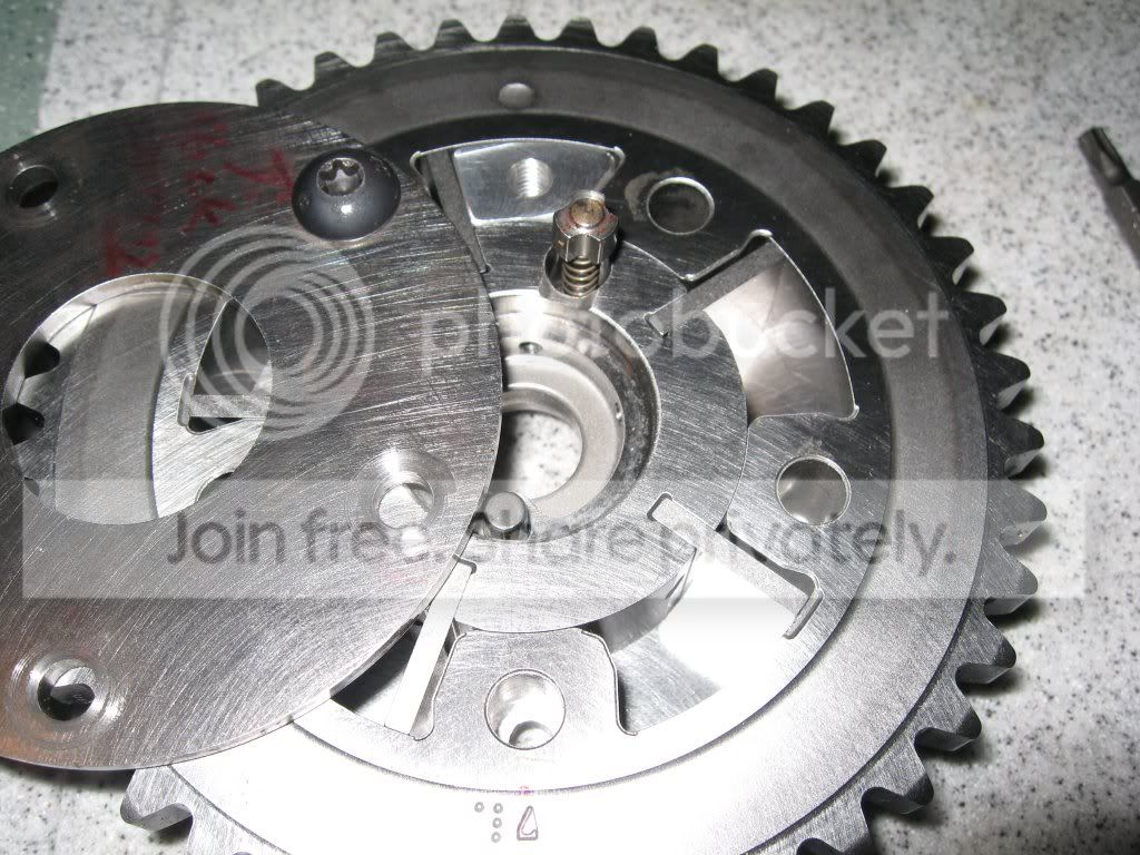

The Livernois "lockout" block
The block "installed" (it can be installed either at "full advance", or "full retard". You better have a really good reason to not put it at "full advance" as shown...

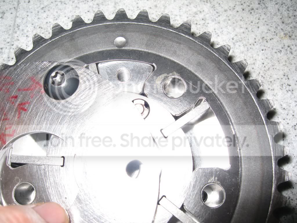

If you were installing the blocks "normally" (without disassembling the phasers as I have), then this is how you would do it. Leave the bolt that holds the clock spring in and rotate the plate to the side... That way you don't have to reinstall the clock spring
Press down the oil metering "thingy" and slide the plate back over...

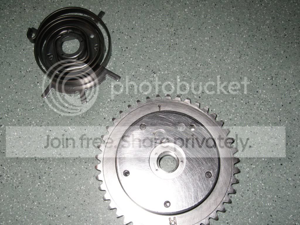

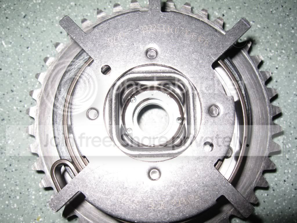

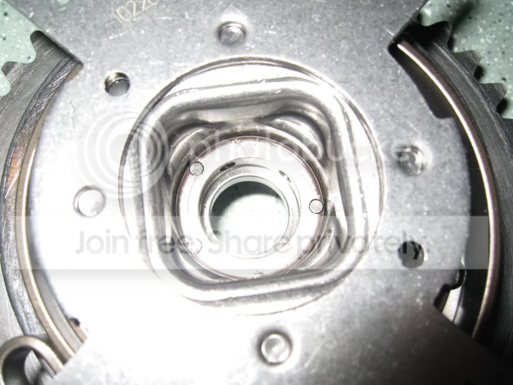

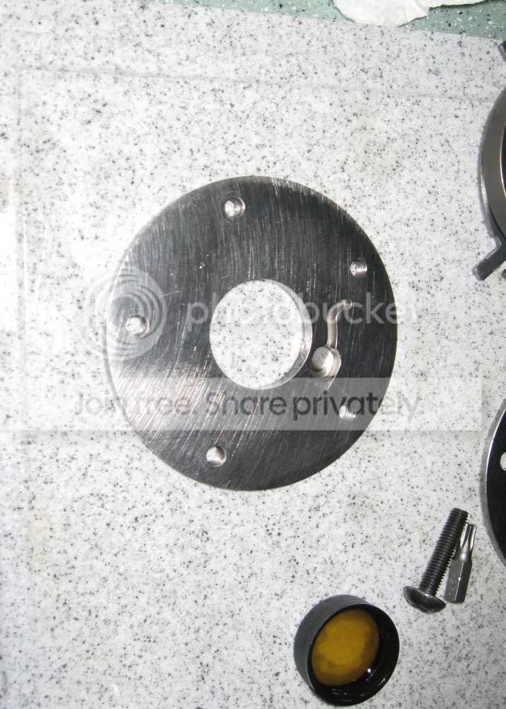

Now for the cam sensor trigger wheel (and clock spring, though it will go on without tension - note the orientation... )

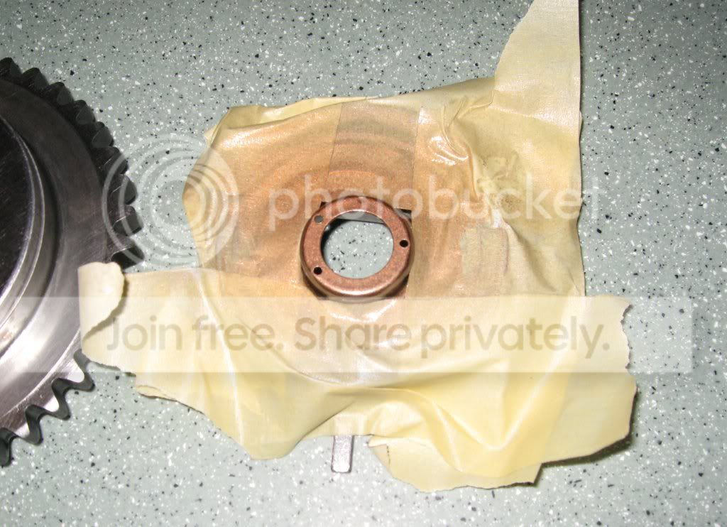

Not wanting to leave anything to chance, I put some copper head gasket sealant on the back of the clock spring

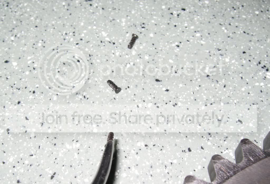

See the three little tiny holes? They line up the trigger wheel (the funny shaped thing on the top with the "fingers" that triggers the cam position sensor).
The old phasers had straight metal "dowels". The new ones have these twisted dowels. In either case, they "press in"...
Itsy little things - I used forceps to put them in place...
Pressed in with a carefully chosen socket that had a flat face of the correct diameter to rest on all three dowels...

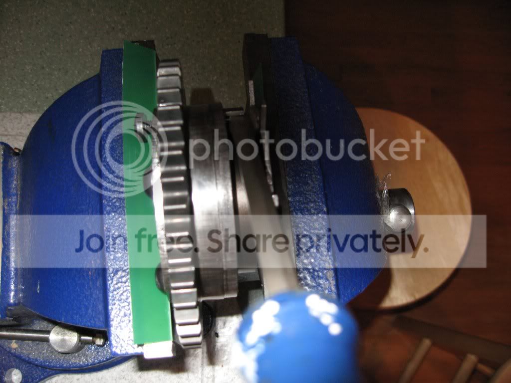

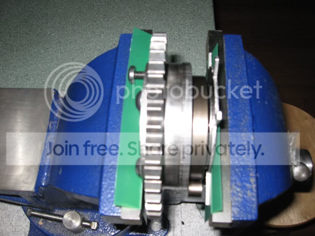

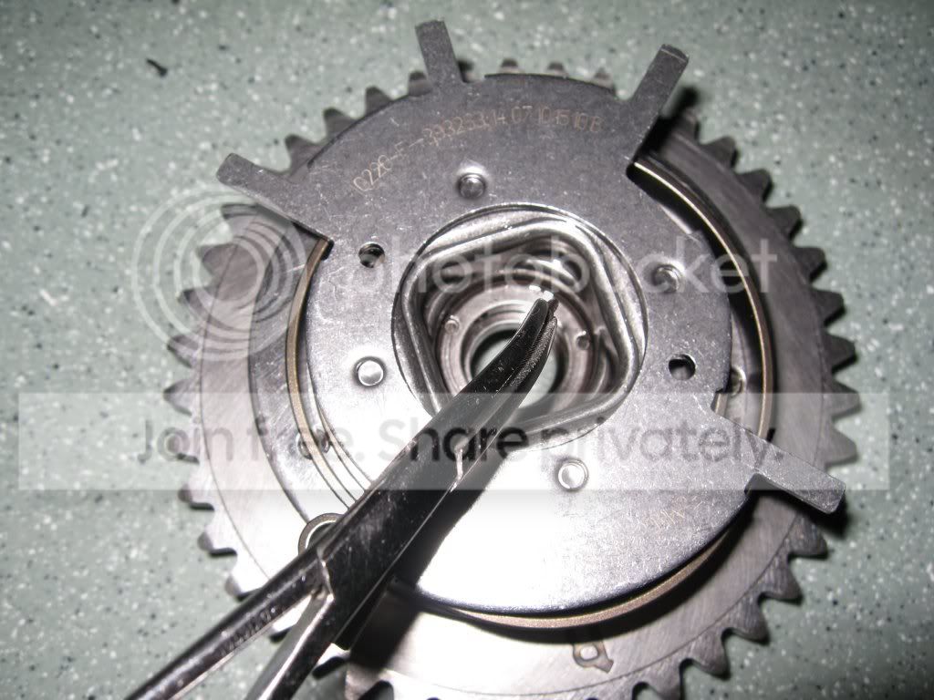

Now for the spring. I placed the entire assembly in a vice (CAREFULLY - you are not trying to crush it - just hold it - I removed bolts as needed to give a nice flat surface for the vice... Note the bolt/screw sticking out - that is the one that holds the clock spring...
Carefully push clock spring up and over towards the bolt that holds it (using big regular screw driver). When you get it in place, push the bolt through far enough to engage a few threads - you may have to hold the spring to allow the bolt to thread (otherwise it twists the bolt out of the center - so keep tension on the screwdriver until the bolt is threaded...)

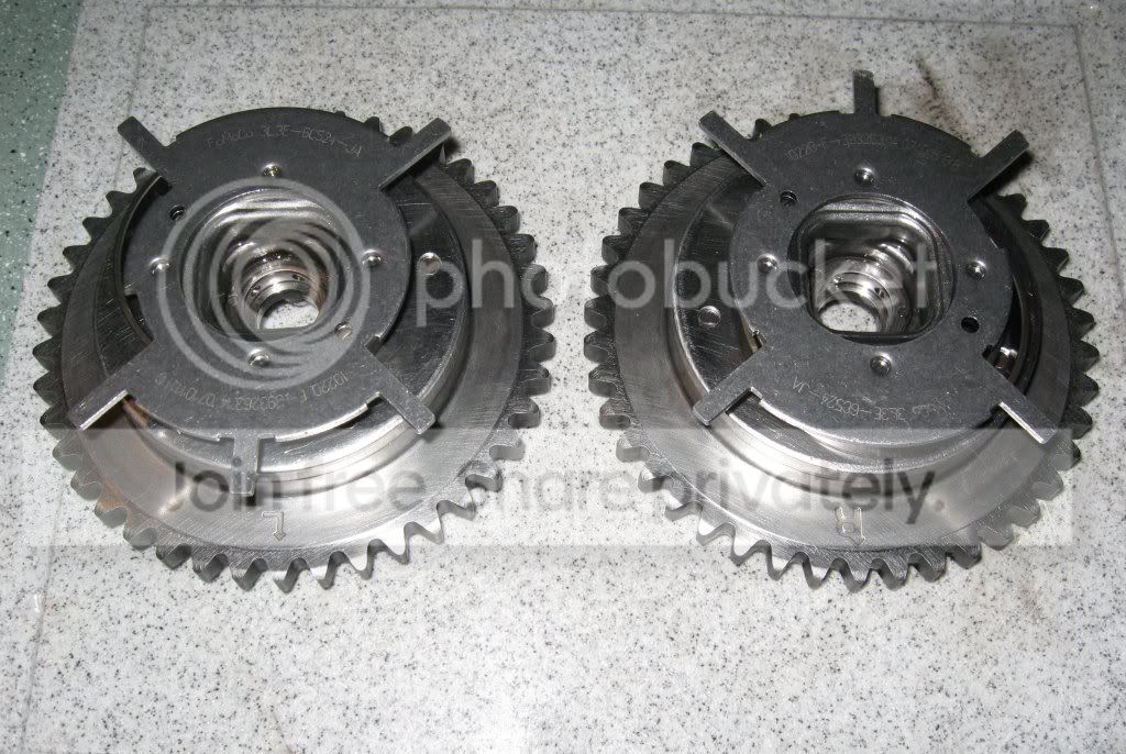

Tada - two coasters! I mean, locked out phasers... Ready to go back on the car...

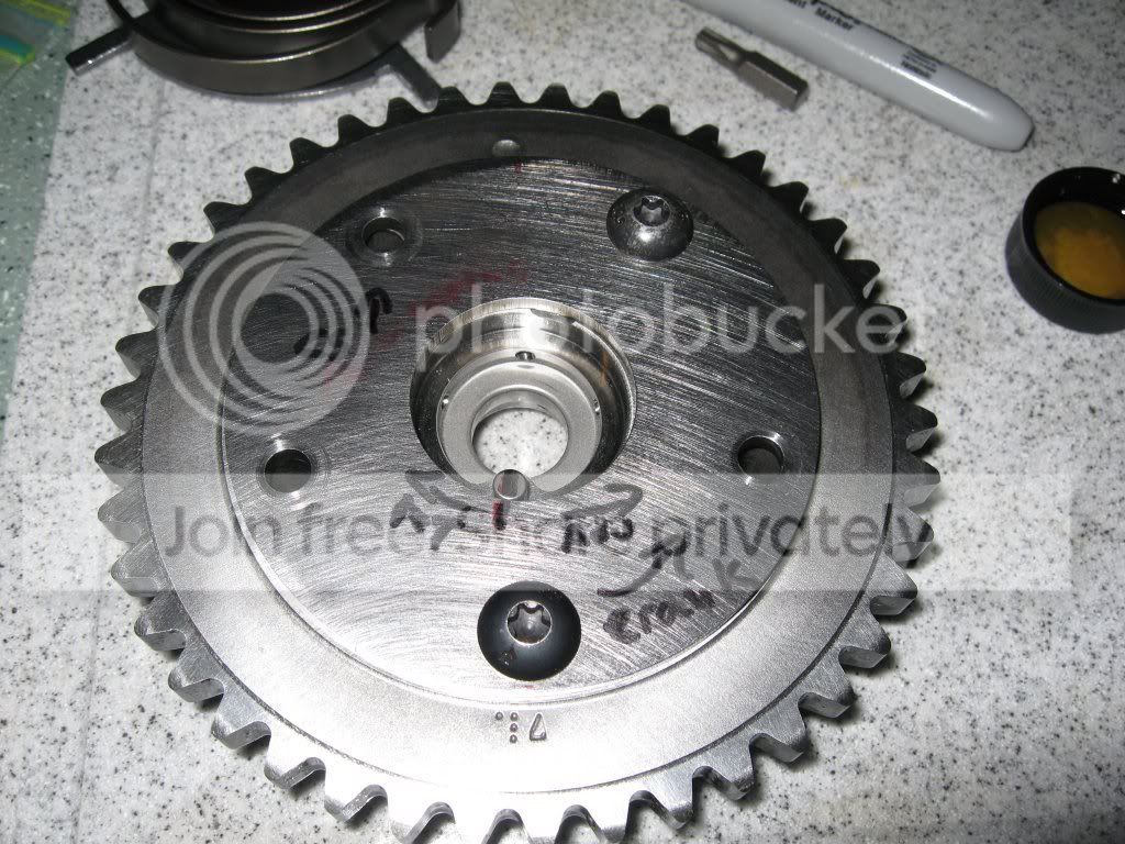

BTW - just for my own sanity since you are working on the back-side of these things most of the time, I scribbled on it with a Sharpie to keep track of orientation of the gear, engine rotation, advance/retard and the location of the clock spring...
