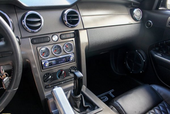

So I recently got my second aftermarket gauge for oil psi. I don’t personally like the A pillar or the middle dash mount locations. Can everyone show me their setups? I REALLY want a triple gauge panel that is where the radio is. So a single din radio on top and triple gauges under it but u can’t find anywhere that makes that’s. Thanks!

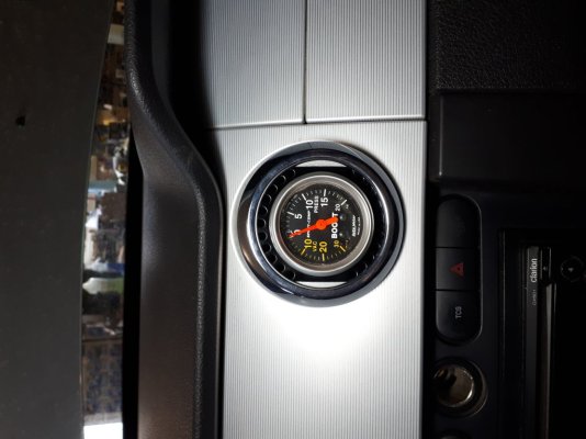

This is another option. Sorry about the sideways pic, not sure why it's doing that. I have my wideband mounted in the other center vent. I actually prefer the look and function of the center pod posted above by 07 Boss but I wasn't willing to put holes in my dash.

I haven't been able to find anything that's already put together like what's the picture in the first post. I tried the three gauge pod on top of the dash, but it interferes with my vision when autocrossing. I bought a single DIN gauge pod that should work with minor modifications with the American International FMK540 stereo installation dash kit. I should know later today.

I was able to make the single DIN gauge pod work. I went with the carbon fiber one. It was a little too wide so I used a dremel to trim the the width of the gauge pod. I also used a dremel to trim around the gauge in the dash kit.
The side brackets in the dash kit holds the gauge pod in place so I didn't need to glue anything. Everything seems to fit together really well and I haven't noticed anything moving, but I have only driven the car once with it installed.

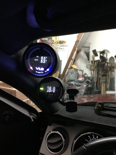

That actually looks pretty good. I went in a little different direction... good end result IMHO. Used VLS Air Intake/ Compressed Temps; AEM Boost/AFR, and Innovate dual gauge pods (Oil Temp/Pressure; Volts/Water Temp). The gauge POD for the review mirror was custom made by a guy named Zac using original light pods. He calls it the ZPod. Think I got the last one. Tried to get another manufacture to make them. Found out the OEM Pod is the only one that'll hold up due to what's it made of (glass embedded fibers I think). The plastic version we tried to make just break at the connectors. No problems using the review mirror either.
