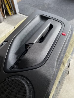

Door trim panels can be replaced for under $100. I think it looks better than stock.

Yeah the door trim is trash. I had to reglue one of mine last year or so, but it still just looks ok.
Yup. Both of mine peeled up and I eventually pulled them off. Now I can't find the driver side one, but since the car is gradually becoming more track and less street I may find another way to deal with it or just live without trying to re-install them.

4. The Door panel is shit. I think its not the glue, its the chemical disintegration of the foam, but must do it now :(

Door panel issues solved with Coverlay, I had mine painted to match correct color of interior, I have a Hurst shifterwhich works fine, my 4.6 has some modes, cams LT headers and Flowmaster exhaust, a tune by Lito solved all my problems, with idle etc.

I don't see how you guys are content with the Coverlay panels. My car came factory with the diamond pattern vinyl/leather inserts, and replacing them with painted panels would seriously cheapen the look of the interior, IMO.
