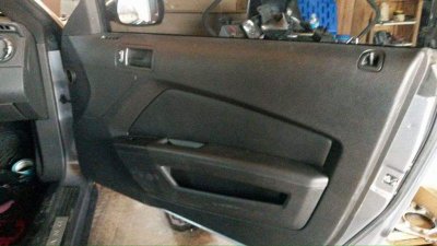

Here's passenger side. Dirty in the pic from just installing it
That looks good!.....I am very close to committed to the Scott Rod panels. But still going back and forth.
