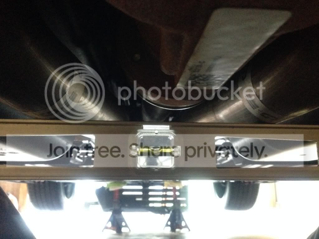

I'm surprised you have allowed rust to show on the diff Darren... Your falling off man...

What I recommend is, find out what your thrust angle is. If it is between .25 and -.25.....then fixed LCA is fine. Anything over that, I recommend (although not "needed") having adjustable LCA to dial it in and square it up. But typically, yes, what you asked.....fine for most applications.
mine was off about 1/2'' from side to side before relocation brackets. I'm the only owner and the car has never been wrecked, other than hitting a deer which was minor damage.
the other thing is lowers are easy to get to to adjust.
Happens all the time. We test a lot of parts on local cars (and of course our own) and we see 1/4" or so variations quite often. 1/2" is a little more rare, but I have seen it.
I recently had a customer bring me his car, with only lowering springs installed. Axle was off 3/8" from side to side. (wheelbase)
