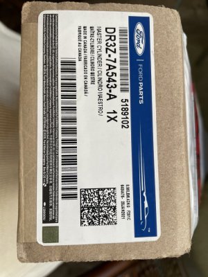

The slave Cylinder sometimes referred d to as throw out bearing on older car,
Is same on Gt Mustang and Gt 500.
The clutch master cylinder is what is different on GT 500.
The part number for 2013 Gt 500 is DR3Z-7A543-A that work great in Gt Mustang.
I have new one in box if anyone is interested. Very hard item to find maynot be making them anymore.
PM me if interested.
