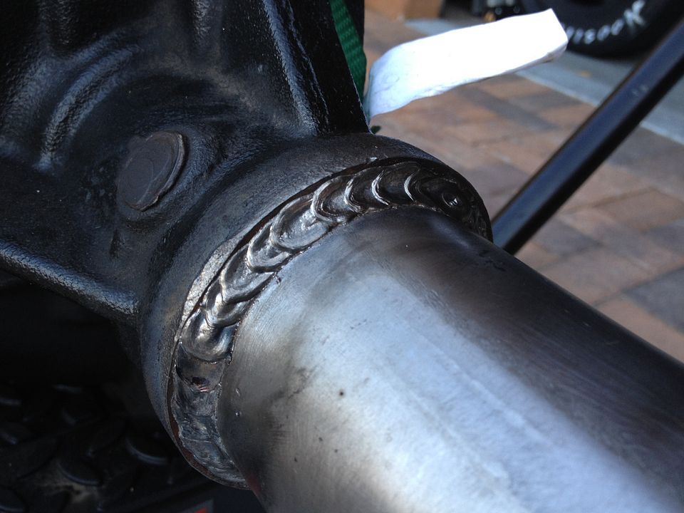

yea i also thought about repainting the rear while i have it dropped out,
That would be a good thing. When I did my rear diff I had the axle tubes and all my bolt-on suspension brackets welded. Don't know if that is necessary for you but I was racing my car and did it for peace of mind. Plus, once you get it all cleaned up it presents itself well.
yea funny thing is im a welder , and i was planning on welding up my stuff as well,,
but i think im gonna tig weld it so it looks pretty and seamless
