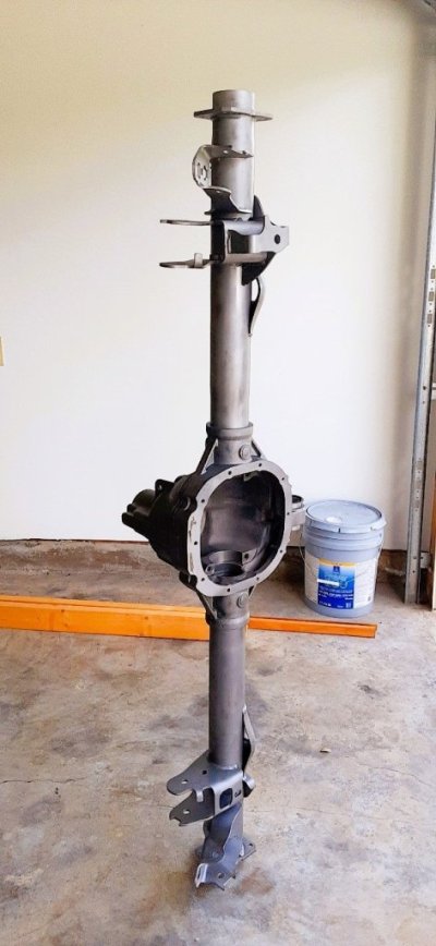

I did my 410's out of the car. It was my first time doing gears so it took a number of tries to get the shimming/pattern right. It would have been a real pita doing it on my back, especially for an old guy like me. I also did the UCA bushing, seals, bearings and painted, so do all that on a bench was much easier too. Definitely worth the effort of getting it out of the car.

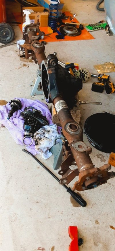

I did it two times, one on a big lift and the other in my garage. The up and down, up and down takes a lot of time and for me it would be impossible to crush the spacer, so I used a solid spacer, which I would recommend anyway.
I hope there will be no next but I would take out the axle now.
On the lift I needed 2 full days on high speed and in my garage 8 evenings (I wanted to be very precise with shimming)
The Trutrak is one of my best mods, was worth the work.

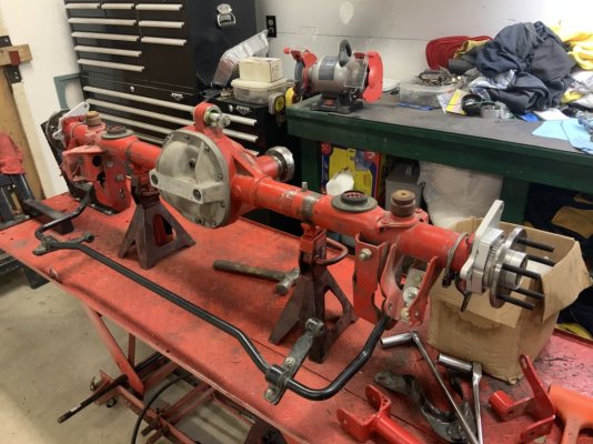

This is much easier on the back and has an unobstructed view. Everything is within reach.
Done it both ways...............best by far is out from under the car period.......especially if gonna change out the pinion bearing races........especially the inner pinion bearing race.
Will never do this w\ this integrated designed SRA still under the vehicle again.................
Now I see your full rig, Midlife Crises! What brand of setup is that cause I want 1 of those..............was wondering how you were going about this........now I see!
