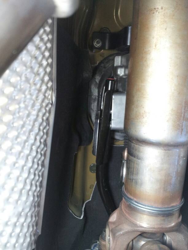

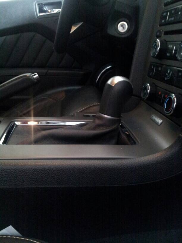

Here's a pic of the shifter in the car now.

Lucas, I have no idea what I'm supposed to be looking at in those pictures. The shifter looks like it's either in 1st or 3rd. In the second picture the black piece doesn't appear to be seating flat against the shifter housing, maybe a bolt is missing?

He's saying the gear selector is much farther toward the front of the car than it was previously when in 1, 3, & 5.

The shifter is too far forward in the console in the first pic. That's the car in 1st gear. But the shift knob is damn near in the dash! It's really stretching the shifter boot out with it like that.
The second picture is of the shifter housing and the shifter brace. That's the shifter put in the position it needs to be in, as you can see, the brace will not bolt up without tweaking the shifter to one side and pulling it forward. No missing bolts

So, I tried loosening the crossmember bolts today, even took the crossmember completely down and jacked the transmission up and down. No dice. It's slightly better but still pulled forward and slightly to one side. It doesn't seem to matter what I do, nothing will straighten it back up. I don't know what to do. I'm out of time to mess with it as I have to leave town next weekend and I'm not taking it back to the dealer right now to leave it with my wife to mess with. The gripes with the transmission are definitely gone, but this shifter thing is driving me nuts.

The brace does look bent to me. Don't ask how they could screw something up, remember Murphy's law. I don't recall mine ever being that bent outwards, it was more straight.

Eff that. They screwed it up the first time. You can do this trans in. Take it out and square it up and reinstall.
