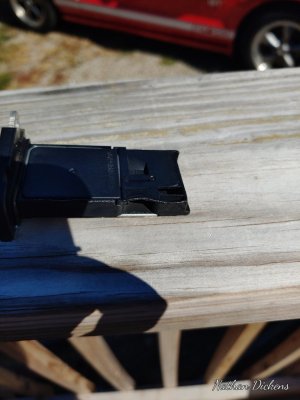

I think it might be my maf sensor its looks melted could this most likely be the issue... An what could have caused this??

An car does have a few mods done has bbk longtube headers into a bbk xpipe with a cat delete, stage 2 nsr comp cams has jlt series 3 cai an has a dyno tune if this helps.. Thanks for anyhelp!
Even without the poor grammar, you also failed to mention those important facts.
I don't know what could have caused the MAF sensor to melt, but the header tube isn't far away and it could be radiating a lot of heat.
Replace the MAF sensor and wrap it with DEI Cool Tape.

Quite likely. If the car starts and runs better with the MAF disconnected, replace it.
Never mind. I saw in your other thread that you've already tried that and it made no difference, but I suggest you replace the MAF sensor anyway.
