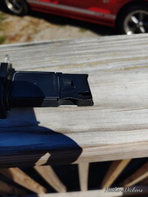

As far as the OP's problem goes, it's worth replacing his since it's slightly melted. There's no guarantee it'll solve the problem and, in the worst case, he'll be left with a good MAF sensor as a spare (unless his MAF sensor is indeed defective and he's unlucky enough to buy a new one that's also defective).
