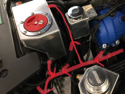

I have a Kenne Bell. On the KB, the water line from the IC/manifold comes around on top the driver's side valve cover. It normally loops up to the degas bottle on the driver's side. That's the opposite of my SCs.
So, to use a Moroso GT500 stainless tank and keep roughly that same KB water line routing, it was easiest to have it 'T' down low near the antilock breaking system. It creates a direct path for the fluid to bypass the bottle entirely. The routes to and from the degas end up going upward to get to the incoming and outgoing barbs of the tank. Based on gravity (and probably the infamous KB water flow restrictions), the fluid takes the path of least resistance and comes around from the manifold and flows downward to get to the pump under the left headlight. I can see no flow in the bottle -- it just expands and contracts based on temp, just like the engine coolant setup. Hope that makes sense. See the picture.
When I pulled the front bumper off, I found that mounting the pump to the front frame right below the left headlight made the most sense. Again, this was a direct, gravity fed route from the water line just above it by the antilock brakes. I just drilled a couple holes and used the GT500 pump mounting bracket.

Thanks for the compliment on the tank(s). The red topped one is the Moroso GT500 tank. The smaller is the power steering reservoir, which I relocated to the valve cover. The bottom one is a Canton stainless tank meant to be a degas bottle for the Kenne Bell cooling system in the earlier years. I modified it to be the windshield wiper reservoir.
