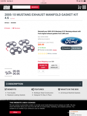

I second not using the BBK gaskets. I did and had to get new Ford gaskets as the BBK ones leaked. Also Napa sells studs that I've been happy with.

Ok, now I have the right bolts and gaskets. Now I'm looking for a mid pipe. Looking for an off road x or H pipe that will work with my long tubes. All the off road pipes I'm finding are for mid length or stock replacement. Finding plenty catted x pipes, but I'm planning on deleting the cats entirely. Thoughts?
