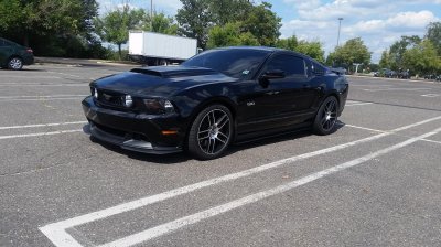

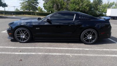

Lowered on Steeda Sport springs, 20x10 Niche wheels, 40mm offset, rear 305/35/20's ... this is what I was getting until I lifted the back of the car about 0.75-1" ...
As far as how those wheels/tires fit, yes they stuck out a bit, but I think that was only the tire, and a 275-285 tire would not rub:
I really wish the Niches were a 48 offset, like the AMR's I had last year, since the same 10" width with the same 305/35/20 Nitto 555R's fit perfectly with the same Steeda Sport springs, with no rubbing:
The way the car was sitting here was tucking the left rear tire into the fender, something that most likely would've caused an "interference issue" with the 40mm-offset Niches:
This last pic shows the tale of 10" wheels front and rear, but the fronts have 275's on them and the rears have 305's ... the front tires therefore fit perfectly square (even with a tiny amount of stretch which is ideal for front fitments, for cornering), while the 305 rears are bulging out, which on a 40mm-or-smaller-offset wheel will cause fender rub/contact, but on these 48mm-offset wheels, like I said above, there were no issues:
