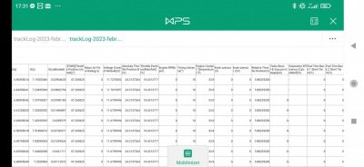

2010 Mustang 4.6 3v , from cold idling no problem, when the fan turns on the fuel trim will be high. i get p0171 p0174.

192.2F on fan= high fuel trim, 0F-192.2F= correct fuel trim
