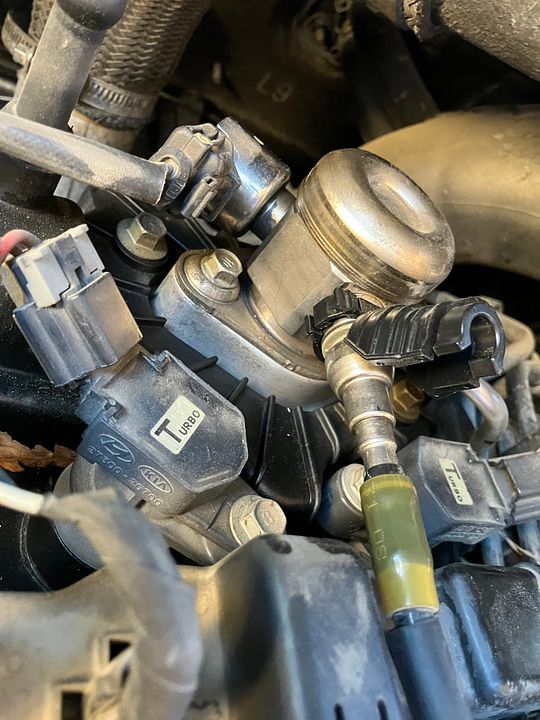

Anyways, 2015 Kia Sportage SX 2.0l Turbo w/Direct Injection. The connector from the low pressure line to the HPFP is leaking. I want to replace it but have encountered a fuel fitting I'm not familiar with. I have a pic but just cant figure out how to release it from the pump. If anyone has experience with this kind of fitting, please enlighten me.
There is the light green plastic piece at the very end of the line that moves a bit and the fuel line also has a little back and forth play but I don't want to pry and tug too hard as I'm afraid of breaking something and it getting stuck on there.
Thanks

Might be this...
Thanks you sir, you are a scholar and a gentleman. I couldn't figure it out and all the other vids I found had a different style connector. I'm going to cut that connector off and just run a piece of hose with some clamps. Kia wants $400 for the "assembly" that that connector is attached to. It's the low pressure side so I ought to be ok. Apparently its all one piece running all the way back to the tank.
