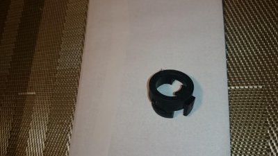

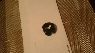

Well i finally was able to remove that plastic elbow and insert the line correctly! Although i did break a plastic spacer that goes on the bellhousing and the throwout bearing hydraulic line :rant:
2526Bullitt
Jun 21, 2015
123
27
It seems like this holds the hydraulic throwout bearing line through the hole of the bellhousing but when i connected the elbow back and bled the clutch, there were no leaks. As a matter of a fact, my dad pressed the clutch pedal repeatedly while i was under the car and there is no movement whatsoever.... Still i will eventually replace everything those plastic parts when i upgrade the clutch.
