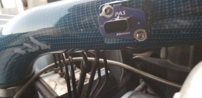

It would start, run a second or two, then shut down. Unplugging the MAF got it running, but basically only at idle. Almost any throttle input and it dies. On a scan tool the MAF reading never changes. It has an older PAS extreme maf. Just ordered an HPX replacement. Tried 2 new OEM Ford sensors. No dice. Tested compression at about 160psi in every hole.

I'm keeping my fingers crossed the MAF failed and given the tuning it won't run without one or with a factory one. I did notice there's no screen before the MAF sensor in the ON3 piping. That seems foolish and may have contributed to destroying the sensor when the pipe blew off a foot before it.

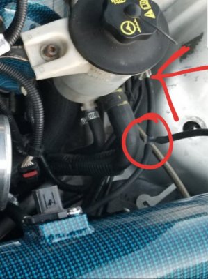

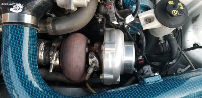

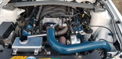

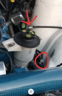

Biggest issue I see is you need to fix the turbo clocking the feed needs to be straight up at the 12 o'clock position. It's likely pushing oil into turbine/hotside or compressor cover and coldside. Remove the bottom coupler at the intercooler and look for oil.

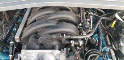

Also looks like the mbc pressure reference is not connected. If that popped out from a manifold source there is a vac leak now. That leak will also affect frps operation.

Also all these connections are suspect. It's a good idea to use a cable tie or clamp etc on all these T off barb lines.

Photos are misleading. That MBC isn't being used anymore. The previous owner left it underhood when the new one was installed in cabin. We have been smoke testing and checking every line on the car to find leaks. I cut all the zip ties to check all the hoses. These photos just don't show it buttoned up correctly.
Interesting someone caught the turbo clocking issue which I intended to remedy today. It's the only thing I caught from reading on3's website lol. Not sure why it was installed this way. It's a fairly fresh build, had less than 3,000 miles on it when I bought it. I've put less than 1,000 on it.
To summarize, I've returned the car to exactly the form I got it in. The boost pipe failure was likely our fault. The day before it blew off we removed that pipe to check the throttle body for dirt or debris. It only had a turbo guard on it when I bought it, no filter. I even set it back to that configuration lol.
