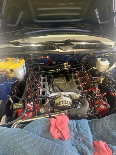

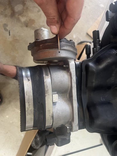

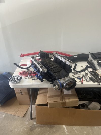

Been chasing a vacuum leak for awhile now, finally decided to rip the intake off and start fresh. Started reinstalling everything and noticed this hole in the bottom. It goes all the way thru the casting…is it supposed to be there?

Called BBK, weap hole. Gonna temp seal it to eliminate as possibility. The (high idle/vacuum leak) issue has been there since start up. I noticed a lot of loose bolts ripping the intake out today. Intake and valve cover bolts were 70% loose. I’m wondering if the heat cycles loosened them or if I just SUCK!! Hoping to fire it up later and get lucky!

The hole looks like it belongs but throw a piece of tape on there to eliminate it. I wonder if it was any of the loose intake bolts that was the cause of your vacuum leak.
Yeah it’s a weap hole, got ahold of BBK. Good help, quick response time. Have electric tape wrapped around it currently while testing.
