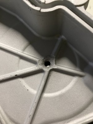

I had my timing cover and valve covers cleaned/blasted not too long ago and the guy cleaning them up noticed where one of the idler pulleys bolts in was popped through to the back side. It otherwise looks good, no cracks. Is there anything special I should do about this when I put it back together? I'm guessing perhaps the previous owner might've put the wrong bolt in the wrong hole or over torqued it. I didn't notice it before I had it cleaned, but I wasn't looking too hard at it.

You can always just use some thread sealer to keep it from leaking if there is enough threads for the bolt to grab. The timing covers are not cast that well. I broke off a boss for one of my pulley bolts with not a lot of force. I had to get a new timing cover but then I was able to paint it and put some really cool pulleys on there.

Check to see if the threads are damaged. They may have used a longer bolt intentionally. I would be fishing in the oil pan for the aluminum chunks.

A proper welding shop should be able to build it back up for you.

I agree with Iceman62, replace the cover.
