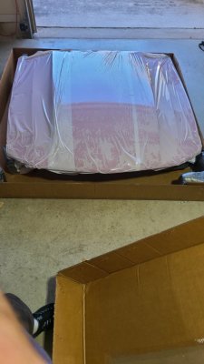

Yeah, I wasn't expecting that. As a matter of fact, I was out of the country when I got an email stating it was shipped and would arrive before I got back. That freaked me out. Fortunately it was scheduled for today (Tuesday) and we returned last Saturday.

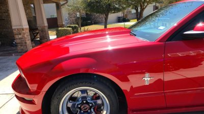

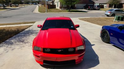

Hard to tell on my phone but looks like a good paint match, I love the look of it, I have the same hood on my car.

The tone of the hood is slightly brighter than the fenders. Over time it may darken a little for a better match. Had the same issue with my sons car (in grabber orange) where a reputable shop that does great paint couldn't match the OEM color/tone. Maybe I've just gotten used to it but over the last year it seems to match better than it did when we first got it back from the painter. The tone difference can often be traced to the color/tone of the primer. Each car/year uses a specific color/tone of primer. Didn't know that until my painter pointed it out to me and demonstrated it. He says many of the paints out there are somewhat transparent and hence the need to use the specific color/tone/formulation of primer and color called for by the manufacturer. Some may scoff at what he says but each time he paints or touches up any of my cars the color match is perfect so I can't argue with the results.

...He says many of the paints out there are somewhat transparent and hence the need to use the specific color/tone/formulation of primer and color called for by the manufacturer...
I've gone as far as to spray several varying colors of primer/sealer on a test panel followed by a practice basecoat to work my way to the best color match, based on the base being "influenced" by the primer/sealer. Particularly silvers, pearls, tri's. Rather that than the cost of time/materials to blend. Of course this is of no help painting parts without the vehicle for reference.

Agreed. The closest you'll get (without the car) is probably being able to get orig primer/paint but I understand there are a ton of other factors that must be considered. I've been airbrushing for over 40 years so I like to think I know a little about color/tone and can lay down good paint but unfortunately know next to nothing about all of the nuances that affect the final result when painting a car so I leave that to experts like you.

How did it go on? Was the fit good? Mine went on almost perfect the first time with only one minor adjustment. Congrats!
