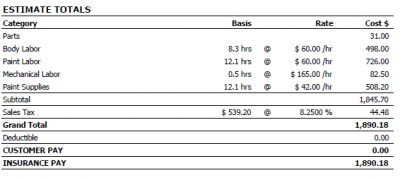

Getting the Cervinis Cobra R Hood. Could have Cervinis paint it for $550. Car's been painted before factory color by this same shop, but there's always variations.
Below are quotes for hood only and hood and fender blending. Both seem rather high but costs are going up with everything. Wondering if I should take my chances with Cervinis painting it and roll the dice on it matching. Or get quotes from other places. I'm in San Antonio, TX.
Hood Only
Hood and Fender

WOW, that shop is a WHORE lmao. Blending fenders AND tinting color? Blend or tint, pick ONE. Prep the hood for 3 additional hours? OMG. To strip and repaint a used hood, they should charge two thirds of full refinish time.
I have a metallic silver car, I had a Cervini glass hood installed. Shop did NOT blend fenders, got the color correct with tinting. One of the hardest colors to match.
A good shop should be able to do that for $500 give or take.
Hardware and fasteners? lol, corrosion protection? fiberglass does not corrode. Blending (if you decide to blend) does not require corrosion protection. Why would you mess with the fenders if you dont have to? Just spray the hood in the booth, car does not need to go in there. Less invasive the better. No need to R&I lamps and bumper that way. And he manually edited the 'book' time for the refinish. (underlined entries indicate editing of book time)
Vehicle scan not required. WTF is he scanning for putting on a hood? Geez
I do this for a living, go to another shop!
Ps: Estimate was prepared on CCCone estimating platform. Post the zip code for the shop, I can tell you what they SHOULD be charging per hour.

Average market rate for zip code is $50/hr labor, $38 for paint.
So he is $10 over market. So yea, definite whore shop.
Note: they are not bound by that, they can charge whatever they want, but should be charging 50 and 38.
Hood R&I, strip old hood, color tint, refinish, finish sand and buff, i come up with $650 for a fair estimate in that market area.
