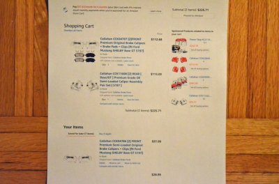

The bottom line. I took everything to the scrap yard. It was 120 lbs worth of old parts and new parts and I got $12. Case closed and I move on. Everything is working now although I might have some air in the line. I will give it a few weeks. In the mean time I will research brake fluid. I had a brake flush with Dot 4 last March. Most likely NAPA DOT4. Maybe I will do it again but might use a better fluid. Any Recommendations?
The reason I think it was sticking brakes on both sides is, I notice now the car backs out of the garage on it's own. The Calipers were 7 years old and now I have new Power Stops. Might order a complete set front and back as backups on Amazon for under $250.
