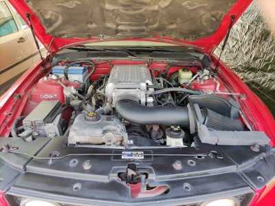

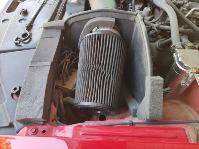

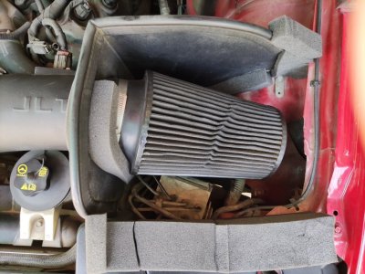

Your IATs are way too high and appear to be the same as what I'd expect your underhood temperatures to be. Do you have an aftermarket "CAI" with a conical filter that's exposed under the hood with either no heat shield at all or a crappy heatshield that's as useful as tits on a bull? If so, perhaps my modified JLT 3 CAI will inspire you. :D

In the last pic, I can see the ABS module. So the cold air intake is sucking hot air from the engine bay.
Those temps are not out of the relm of possible, based on that photo.

I think you're getting confused. ;) Those photos are mine, not the OP's. I have a Brenspeed tune and at any speed over 40mph, my IATS are barely above ambient. I've completely sealed off my air filter from the engine compartment and it takes a few minutes of idling time to get the IAT up to 110*F. Once on the move again, it quickly comes down.
