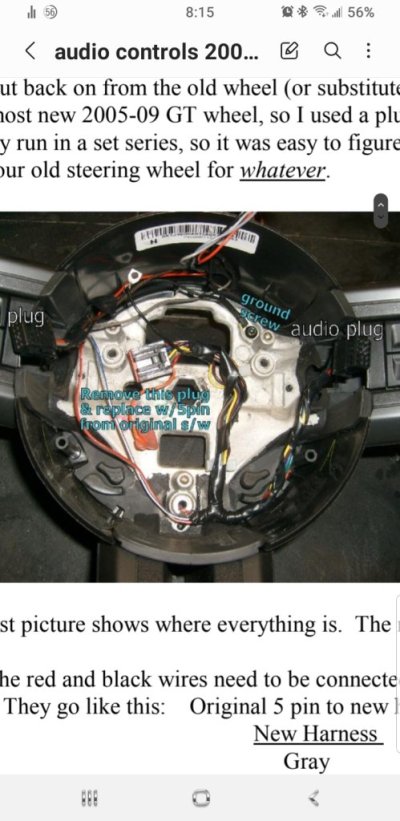

I know it's been a while since the release of this guide but I have a question
Where does the pink ground eyelet go exactly? (after soldering it to pin 7 and 4) Is it there from factory on the 2010+ wheels or is it an addition?1001712667.jpg
