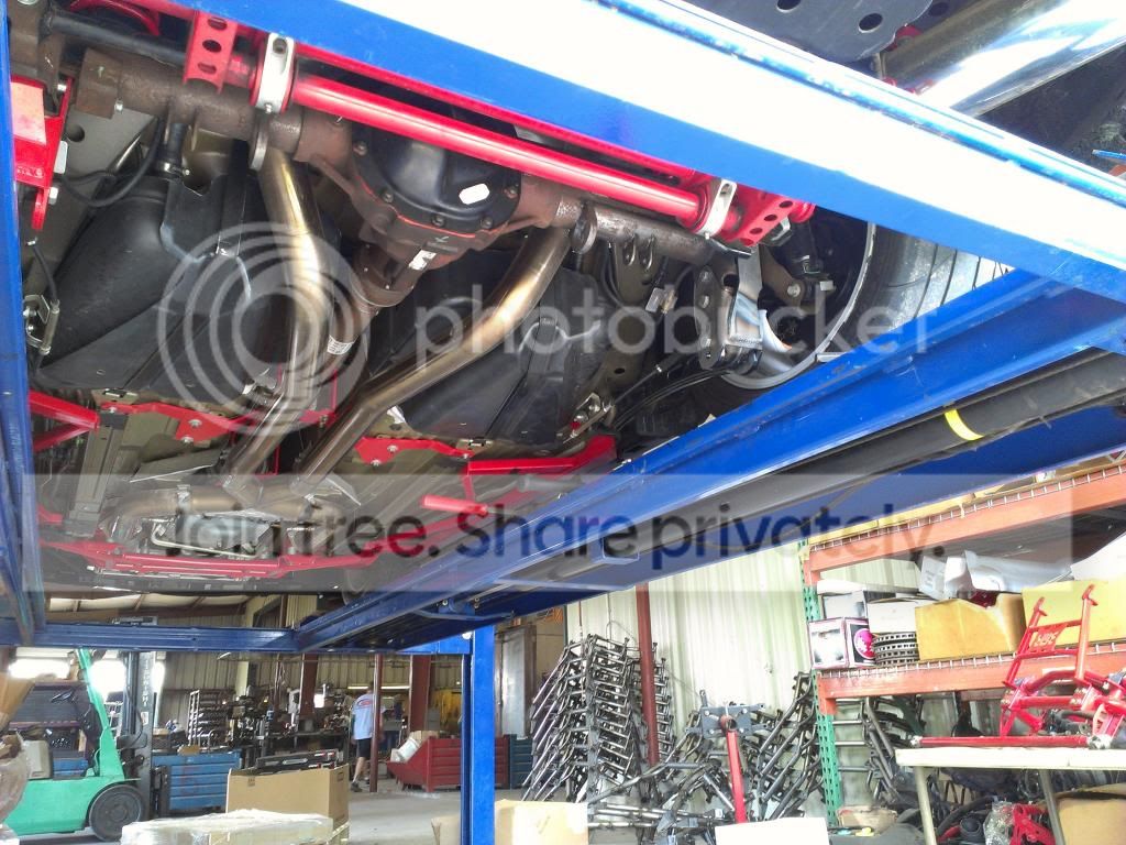

Let me get this straight.
No bracing. No welds. And relocation brackets installed.
Hundreds of passes. 1.3 sixtys.
No failure?
Correct. We do have welded tubes, just not like this thread pertains to. We have tow hooks, and Anti Roll Bar tabs welded to them. :naughty1:
2011, we won the SST Title (NMRA SST)
2012, we got runner-up
2013, we finished in the Top 15 (Top 10 IIRC. We missed a bunch of races)
2014, we are currently #3 in points.
We run the car in anywhere from 10.50 trim, to low low 10.0 trim....depending on what we are trying to achieve.
The last time I checked our spreadsheet, I think we have 321 passes on the car. I would guess that 290 of them, were with LCA Brackets.....and I have no idea the breakdown of the 1.3, 1.4, 1.5 and 1.6 sixties, etc.
Again, I attribute this to having an auto, and "dead hooking". I don't think we have spun a tire in the last 4 years. ***Spinning, believe it or not, IMO, has A LOT to do with twisting axle tubes.
The issue is, when we race NMRA....the slip won't show a 1.3X because we deep stage. Really Deep. So, our slips show like 1.47 to 1.55 (of course, we do have 1.3X slips, when shallow staging.....but most don't show that)

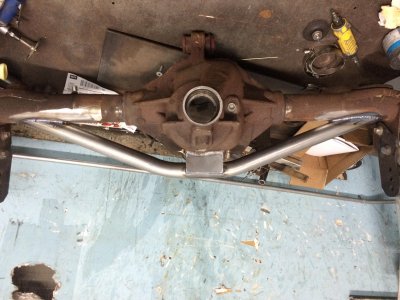

Putting 9in ends on this one right now. But like the bar under the spring perches. Also helps w the twisting. But we charge more than I see a lot of guys saying they pay to get tubes welded. But use and pricey rod we buy specifically for this job, and tig weld it. That way there is immediate heat for penetration, which is something mig just can't do. If it's not hot enough outside we sometimes need to add helium to the mix for more heat. And this is on a 200amp machine!!!

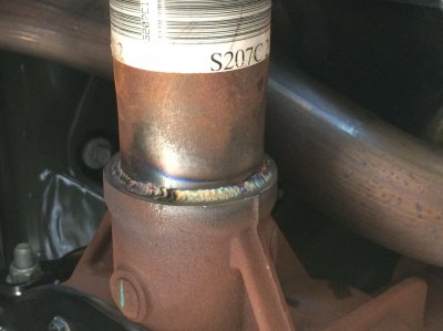

I'm going to go one step further on the diagnosis of this picture and lay my head on the chopping block by claiming that the terrible welding is most likely the cause of the failure. On the axle tube as it comes from the factory, there is no inherent weak spot right where the pumpkin sleeves end. The tubes slip through and are pinned inside the sleeves. I think that not only did the welder not get penetration on the pumpkin with his crappy weld, but he also overheated the tubes creating a weak spot right where he was attempting to reinforce them. The break was right along the edge of his shitty weld and therefore I think having the axles welded improperly (as the images above show) does much more harm than good. I'm not 100% certain but my assumption is that the axle tube may not have failed at that point if it had not been weakened by the heat from the welder.
For some reason a lot of people subscribe to the "just get it welded" theory. I don't think it's that simple.
Hence why nobody is going near my axle tubes with a welder.
