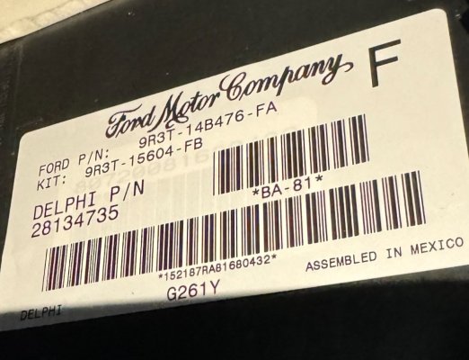

I found a couple of places that have 9R3Z-15604-C in stock. When I reference this it says it was replaced by 9R3Z-15604-G. Can I use 9R3Z-15604-C and have it programmed?

You need to look at your SJB. There will be two sets of numbers. Both have to be the same. You'll have a part number like 9R3T-14B476-HA and you'll also have a Kit number like 9R3T-15604-HB The replacement has to match exactly. If they do not, then there will be things that do not work. Or do not work correctly.

IMG_0554.jpegPulled the cover off today and pulled the panel to get a pic of the part number.
