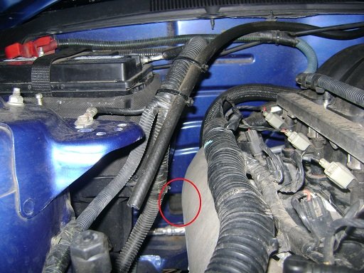

What happens with this is there are 2 cowl drains. It is not uncommon for them to get clogged with leaves or debris. The water that is supposed to drain out of the car ends up draining into the cabin air filter box on the passenger side of the cowl area. That water then trails along the passenger side inner body where the Smart Junction box is. The box is multi pieces but theoretically sealed. Water over a period of time can get into the box and cause the SJB to act up.
If that is the situation it is suggested to replace the SJB along with the Cabin Air Filter as it gets saturated with water.
Picture shown is the passenger side. There is a similar drain on the driver side. Generally won't get as clogged though. We actually just remove them here at the dealer. More drainage is better. Especially in Florida where we deal with alot of rain many months of the year.
