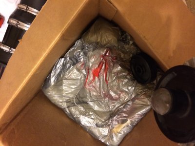

So I just pulled the hu out of the box and it's leaking oil everywhere. Is this normal? It was sitting pulley down in he box.

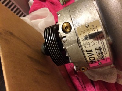

It's leaking from the right brass fitting in this pic when it's turned over or laid down. Is that bad?
No. Looks like whoever sold it to you forgot to put the shipping plug in. Just check and fill it after you install and you'll be fine.
