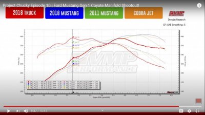

This is an intake manifold dyno shootout on a 2011 GT automatic with a JLT CAI & Dynatech LT headers. The stock 2011 manifold basically lays down and dies from ~6500rpm upwards while the 2018 manifold continues to make power, increasing its advantage to ~25hp @ 7000rpm and ~45hp @ 7500rpm. That's unported. A ported 2018 manifold does even better.Intake Manifold Shootout Gen 1.jpg

This is an intake manifold dyno shootout on a 2011 GT automatic with a JLT CAI & Dynatech LT headers. The stock 2011 manifold basically lays down and dies from ~6500rpm upwards while the 2018 manifold continues to make power, increasing its advantage to ~25hp @ 7000rpm and ~45hp @ 7500rpm. That's unported. A ported 2018 manifold does even better.View attachment 74270
