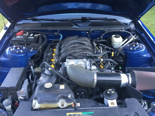

Hello, I have a 06 GT 4.6 5 speed and the rpm’s don’t come down fast enough. Really makes for a slow shift. The car knock on wood idles well any other time. Would a tune fix this issue? I bought the car not knowing if it has a tune or not. Any way to find out? Also I heard that’s there’s a way to put the car into a stock sport mode or something like that. It’s got bbk headers, jlt warm air intake, exhaust as far as I can tell. Any feed back would be greatly appreciated.

RPM decay between shifts is a function of the tune - combination of dashpot tables and decel spark. A tune can make RPM decay more aggressive up to a point.
These cars don’t have sport mode like the newer S197s do, but I believe that’s just a more aggressive advance track/traction control.
With your mods (notably the JLT with a larger MAF), your car almost certainly has a tune otherwise it wouldn’t run.

Your car's ECU will definitely have a tune. Since you have the earlier generation JLT CAI, I wouldn't be surprised if it's a BAMA tune. A new tune will almost certainly fix the rev hang and I suggest you try Lito or Brenspeed.

Thank you all for the feedback. I have noticed a difference in the shifting by letting off the gas slightly before shifting!! Going to do the smoke test and then probably the tune from Lito. I also noticed that the maf sensor screws were not all the way tight. Weren’t crazy loose but I got two turns on them. Right after car threw a po172 code for rich 1st bank. I cleared it and drove it all day and hasn’t came back on. I’m thinking there might have been a small leak letting air in and when I tightened the two screws the ecu had to recalibrate.. maybe?? We will see if it comes back on. Does seem to be come down somewhat quicker.
