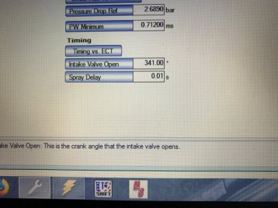

How do you convert the info from the cam card to a useable number in relation to injector timing? I'm not finding a clear answer, or maybe I'm not asking the internet and my books the right questions.
Some info I've found says to set most cam'd combs to 500, but I dint understand that thought process.

you take the intake valve opening number (19 in your case) then subtract it from 360. This is
the value you put in the injector timing field. the way you have it set to 341 is correct for a
cam which opens the intake valve 19* BTDC.
That’s how I got 341, thanks for the confirmation.
