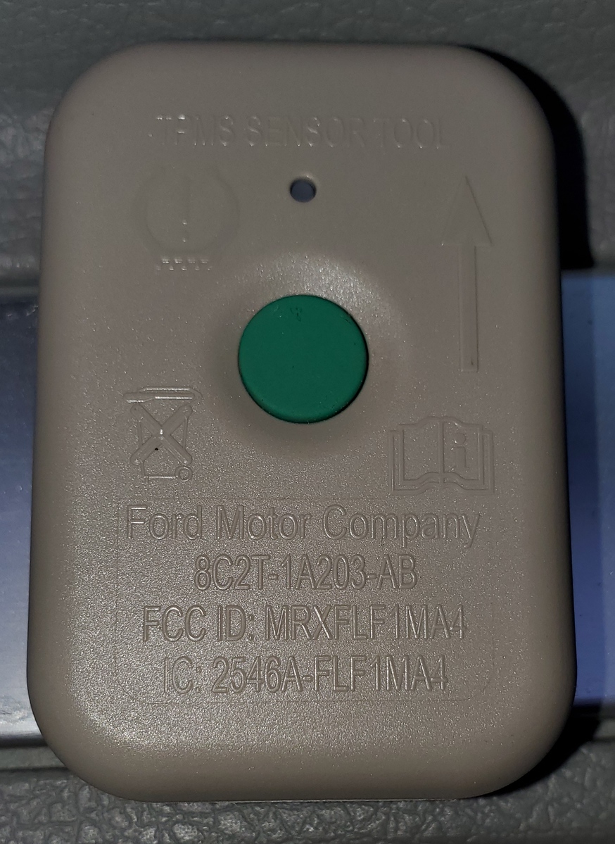

Sweet, that is the kind of recommendation I was hoping someone would have. The AM version just worried me.. Did you buy a programmer too or go to the dealership.

@oldVOR, what brand programmer did you go with?

The Ford programmer (shown not quite actual size)
Works on Ford OEM and aftermarket TPM sensors from 05-14 and 15+ if I'm not mistaken. Works on the wife's 2017 Edge Sport when swapping summer and winter wheels/tires.
