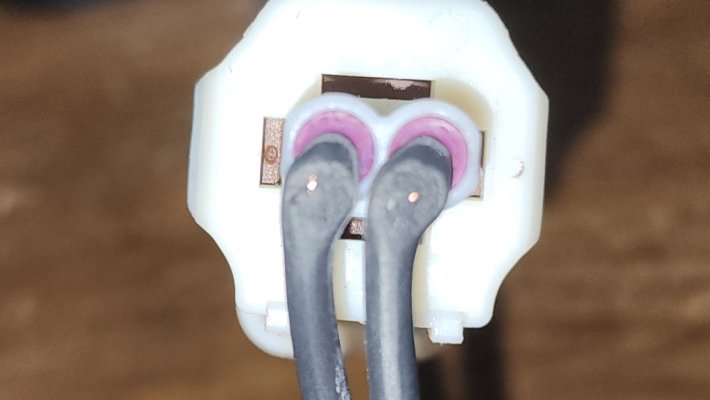

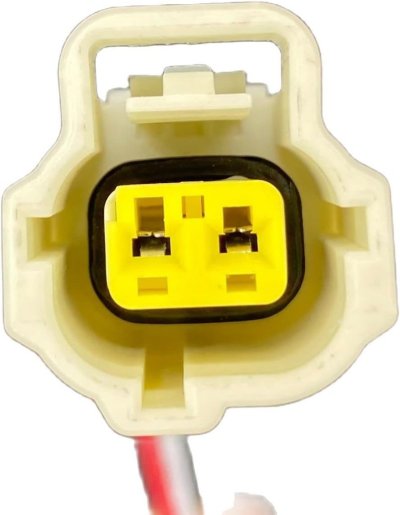

Hi, I am having the same issue but can't seem to find the other connecter. Would you be able to provide a picture of the two connectors or give me a little guidance? Thank you!
dryhero
Oct 2, 2023
P@ss1234
@340demon
Hello! Just went through same experience on 2008 Shelby GT with KB 2.6 SC. Were experiencing odd temp readings. So, installed new CHT sensor and wiring to main harness. Had exact same temp gauge behavior immediately after new install. Checked resistance of sensor wires and found wires were shorted. Ugh! So, removed supercharger again, and short disappeared. Discovered connector wires bent at sharp 90 and exposed conductors. Appears belly of discharge manifold are rubbing on sensor connector wires. Did you happen to observe any pressure on CHT wires?
Thank you for any insight!!

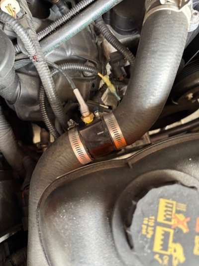

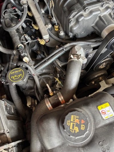

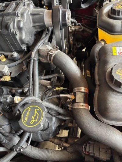

Short of grinding away a bit of the intake manifold or (better) relocating the sensor not much you can do. As far as relocating it if you can find a spot to put it in the water stream somewhere (like the upper radiator hose; there are sensor adapter kits you can buy online) the sensor will work as before; just in a different location. Not sure what size is needed. When I did it I used a 40mm adapter. You'll probably have to measure the inner diameter of the radiator hose to be certain.
Example: https://www.ebay.com/itm/114712393159?_skw=radiator+hose+temp+kit&itmmeta=01JVJ49FMY0BPHWA1V3RQ6T10Q&hash=item1ab56435c7:g:LJYAAOSw~QteVx5z&itmprp=enc:AQAKAAAA0FkggFvd1GGDu0w3yXCmi1dWbfNdCPpRy5dXVwq92YDQHBp+vuu9DX/AyK5edb5pMBISmdlV2NPjunGCiEJD28KOOe1dbzn5wb1vf0ppNirDiu3KJUBVBjV7gsr3Bh9uesrzpX5OxSYr5m8blRLHfwgG3AeBppIhyria+famGiV3aXsdnnxu81zy8L6U6HrTFS+a/jowsA6Hud048VZAgl/ECEROkmU7vKJYS1PwiMy9UESeXBEKJ/LuoxSymQNsId1MarzUXnROXeZn4Nc2JW0=|tkp:BlBMUOL6pcTcZQ
DieHarder
Nov 9, 2019
1,851
1,071
the cylinder head temp sensor is not in coolant in the head
That's correct. What I'm saying is you can remove it from the cylinder head and place it into the upper radiator hose with an adapter like below. Or, if you can find another spot that will place it into the main flow of the cooling system that will work too. It's what I had to do when I installed my DOB supercharger kit. It will still work the same as before and solves the problem with the clearance issue.
If you can post a pic or two of your setup might be able to help ID a spot to plug it in though the upper radiator hose is the easiest to get to and modify. To do so simply extend the wiring for the sensor and place it in an adapter like below. I believe the hose size is 2" (~ 40mm) and the sensor hole is 1/8 npt but don't quote me; you can check by taking the temp sensor into a hardware store, find a 1/8 npt (female) and thread it in to be sure.
