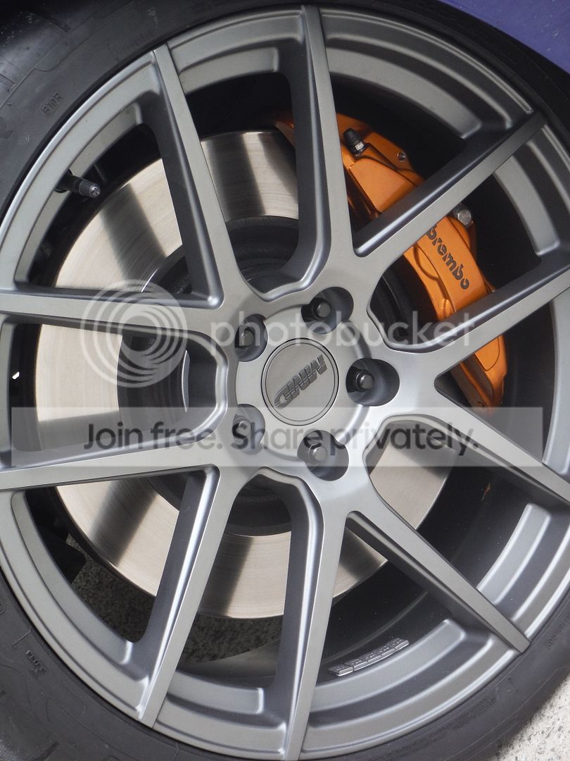

I sold the DF5s and got the MMD Zevens in. Transferred the tires. Waiting on front 3mm spacers. As seen in the pics, the Zevens slight graze the 6 piston Brembos. Wheel can move but with friction. Wheels were not torqued on and I didnt spin. The backpad of the wheel appears seated.
I'll try the 3mm spacer first to see if the wheel will clear the caliper. I figured I don't need much clearance; as stock brembo wheels with 4 piston calipers only have .050" clearance. I like to not go above 5mm on the spacer, because then I would have to go with longer wheel studs for me to feel good about it.

I just want to give a shout out to Will Levantovsky and American Muscle for the great customer service. I just recently bought this MMD Zeven wheels (20x8.5 front/ 20x10 rear) in Matte Charcoal. I was concerned about fitment with these wheels on a 15" Brembo setup from a 13-14 GT500 (6 piston front, 14" rears). AM never had the chance to test fit these on a setup like mine, so I would be the lab rat on this one.
After test fitting, it was determined by me that a 3mm should offer the tiny bit of extra clearance needed. Stock Brembo wheels have .050" of clearance between the spoke and caliper; so I figured a 1mm or so would be fine. Vorshlag Motorsports has wheels fitment so close on some setups that clearance is measured with a feeler gauge. So I think ill be fine.
I took these pictures after install and the test drive. Love the finish and meaner look.
