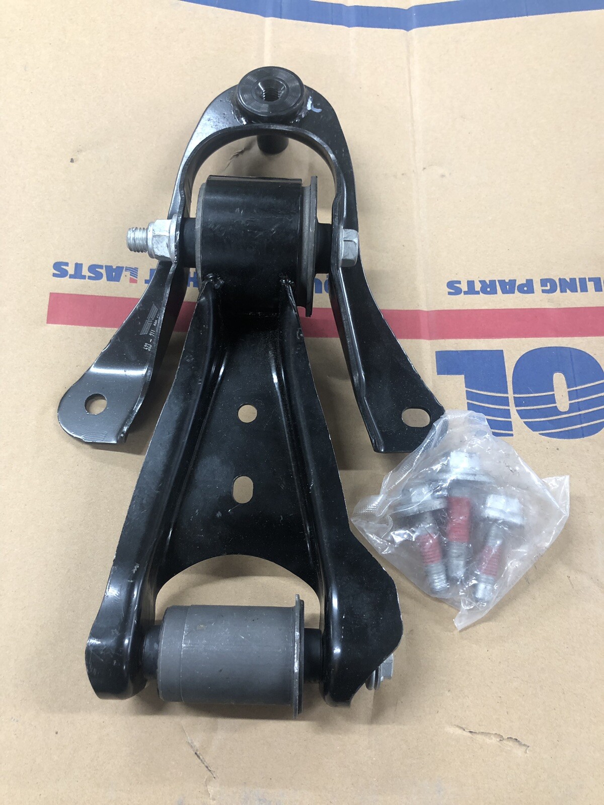

You can replace bushings, but you need a tool to push them out, and press
them in. You can get a whole new arm, bracket, bolts and bushings on eBay
for $70.00 or so. Can also get an adjustable upper arm to reset your pinion
angle lowered.
Edit: A sellor countered my $60 offer with $65 for a brand new, dorman kit;
New UCA with new busing, Bracket (to body), bushing for differential housing,
and all new bolts and nuts.
https://www.ebay.com/itm/05-10-Ford-Mustang-Rear-Upper-Control-Arm-523-211/352687324334
