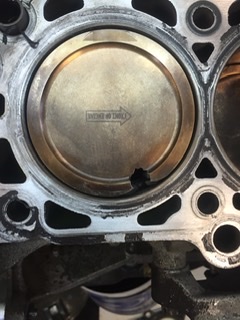

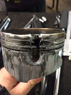

Sorry to see
Mine did the same a few years back and enden up being a burnt a hole in piston #4 . Bought a new sleeve from LA sleeve and resleeved cyl.New piston and rod and back on the road. After this i have never used thoses autolite type plugs again. Have had them melt before that happend on few different cyl but with out any further damage. Now using brisk with out any issues.

I have never dealt with a sleeved engine before - can you resleeve the cylinder without the aid of a machine shop? Or is it pressed in?
Flusher
Apr 26, 2016
527
250
And the block has to be bored oversize before the sleeve can be pressed in.

Did you go with a flanged sleeve or a regular sleeve? I'll slowly tear it down as this is not the best time to be spending money. My local track is closed for the whole season due to covid so I might as well take my time with it.

Not going backward to an iron block unless it is a boss block.
The aluminum blocks are getting hard to come by and with being in Canada, it is a lot cheaper and easier to get a sleeve shipped here than a whole block.
A new block will need close to a grand in machine work to work with my existing gear anyways so sleeving is not that bad of an option.
I went with straight sleeve P/N LA-3820 which cost $110 and it was installed and honed by a local machine shop which did not cost all that much. My setup is 302 stroker with Vortech V3 & Nos and not had any issues with engine since this was performed back in 2016 and plenty of 1/4 passes

Perfect, the shop I use says that they have sleeved lots of engines and have the gear to do everything from straight sleeves to the Darton MID sleeves.
Good to have this option.

Looks kinda like detonation damage. Looks like your intake manifold gaskets were getting very close to leaking as well. Maybe that cylinder has been running lean for awhile.
