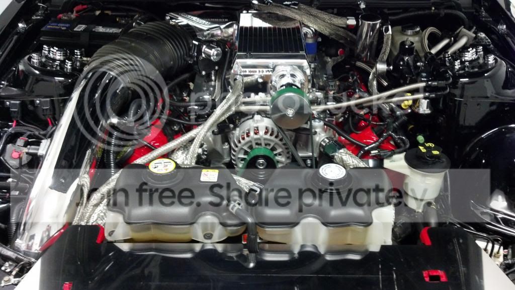

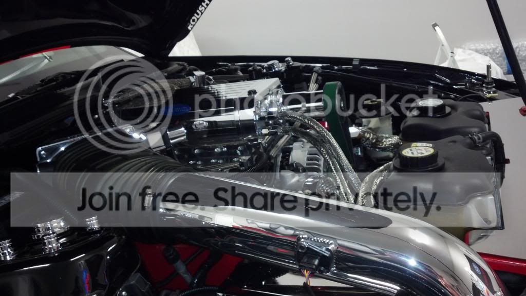

Ha ha. I will get it published out tomorrow bud. I'm still winding down from the absurdness of it all so I don't come out sounding like some outta control know it all southern redneck tonight. Meanwhile here are a couple pics of some polishing love I had to give it tonight to celebrate. Gave her a fresh oil change for the follow up tune tomorrow with Sir Lund. I do appreciate everybody that bothered to give a shit and chime in. Thank you.
