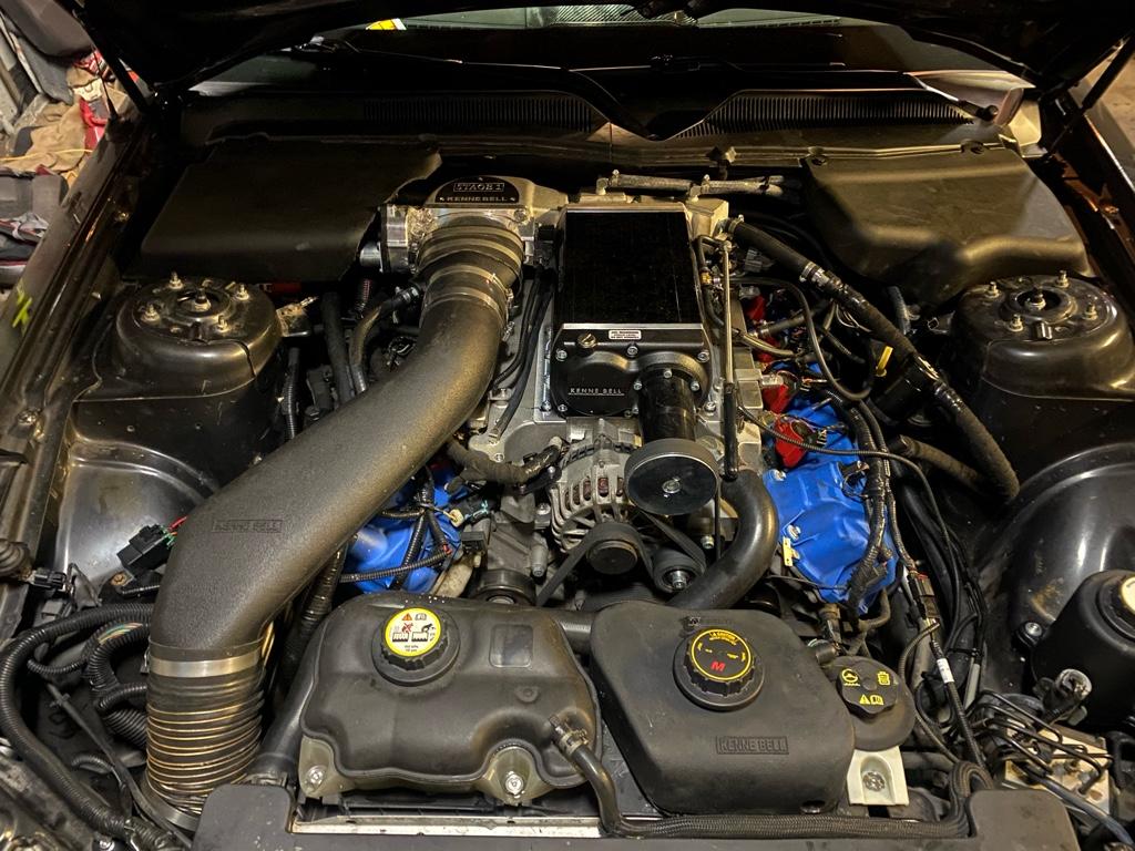

I got the install all done and my no start issue figured out. Car runs great. Did a small pull in third gear from 2-4000 rpm and boost gauge maxed at 5psi. I checked for vacuum leaks with a smoke machine and found none. I do have a softer spring in the BPV because I have cams. I spoke with mike at kennebell and told him I had cams and longtubes and believes that’s why the boost is low. I sent a picture to him and he said everything appears to be installed correctly. He wants me to measure the pulley and get back with him so he can send me another one to get back up to 9-10 psi. I was wondering if anyone else has had this issue. The boost gauge does not jump around it stays constant. At idle I have 11-14 hg WOT goes to 5 psi (Atleast to 4000 rpm) and when I left off it goes to 24hg. belt doesn’t appear to be slipping. I have all stock pulleys on my car. Lito asked if I had udps I said no. Only mods besides the blower are hotrod cams, bbk ceramic longtubes , custom fabricated off-road prochamber and that’s it.

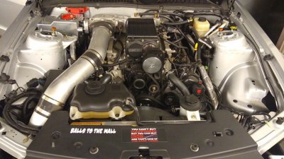

3.5 is fine by and trust me I know how a kb works15960762053928802863152345416787.jpg

3.5 is fine by and trust me I know how a kb worksView attachment 73927
Okay is 3.5 what you have? And tell me, what tube do you have for the intake. That looks loads better.
Racer47
Doesn't have much to say
Sep 11, 2009
1,065
324
SE Wis
I made the intake out of 4" round alum. 3.5 top, 10% OD bottom

Looks like the intake setup I fabbed up for mine!
