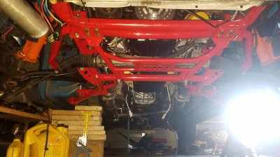

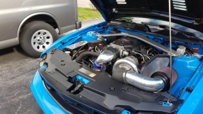

OK here is the update.... My car is now alive! Spent the better part of a few months doing the entire build myself. Engine, transmission, suspension. Tons of long nights and busted knuckles. It all paid off though.
I traveled up to pro edge tuning in ct to pick my car up from bill miller who spent a ton of time and diligence going through my car with a fine tooth comb double checking my worksmanship before first startup and break in. Bill broke in both my motor and clutch for me and then went on to tune it.
Bill went conservative with the tune as this is my daily driver and still pulled out 662hp on his mustang dyno which he admits reads on the low side. I drove it home to Rhode island and from idle to wide open throttle I have no hiccups so far. I will upload some pictures tomorrow.

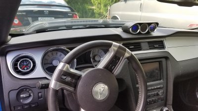

Updated photos and added video. Have to bring it down tommorow for an alignment and hopefully have it pass inspection.
