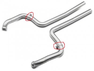

Problem joint is in red.
I had some orange RTV in the toolbox. Tight space in there but I was able to get some gasket maker on the flange. Pulled the clamps over it so the lip of the clamp was just over the flange. Let sit for 24 hours. Test started it yesterday and I can't find a leak now.
How long that lasts is anyone's guess. A longer term solution is desirable.

Is it leaking air once the vehicle is warmed up? It's not really a bad thing they leak water, it prevents it from rusting out your system, clamps, or hardware. Even in a stainless system I think I would rather the water "leak" out than boil off. Also that area isn't far from the A/C system drain.

Not sure. I felt the leak right after starting the car and within a couple minutes of that. Did not warm the car up fully and see if it seals. The leak was pretty bad. Could be heard and easily felt. Been reading around and it seems like this type of joint is notorious for leaks. Unless I figure out a better idea once the leak gets through the gasket I made then I'll have it welded up. Usually a last resort but at least you know that is gonna fix it 100%.
