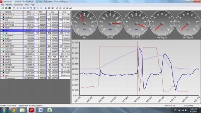

I think I've got it (for real) this time!
I was talking to Bobby at S&H today, and we discussed the T-valve looking thing that connects to the line running to the passenger side. It has a cone shaped section that looks like it would be for allowing flow to only one direction.
I took that off, shook it, and it sounded just like I thought: a gunked up ball & socket setup.
I blew air in the direction fuel SHOULDN'T be flowing, yet I still could. PROBLEM!
So I took it out, connected the line like this:
Immediately I saw improvement, even before I started the car. Used to, I would "prime" the pump, but rail pressure (as read on my dash gauge) would go up, then fall very quickly. I thought it was because there isn't a check valve, but then, like someone said earlier, no check valve should be fine.
Now, pump primes, then holds pressure (still no check valve).
I go for a drive, do some data logging, and when I'm WOT, NO PRESSURE DROP AT ALLLL.... Last time I said I think I had fixed the problem, it wasn't a rock-solid 52psi. NOW it is!
I do several pulls, all the same! Attached is a snapshot of a data log, showing RPM, throttle position, and rail pressure (delta rail pressure should be 39.1 +/- 5psi, something like that) and you can see that it is! My dash gauge shows ~52psi because I'm running about 12psi boost.
Now I have to drive back home (115mi) tomorrow, and that will be the true test.
Are these common to fail?
-Brad
