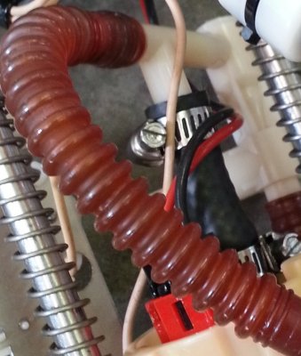

Good catch! But i didn't understand what you explained about that T valve thing...lol
Do you mean that white plastic union that holds passenger line? Any pics?
If you removed that part, you'll only able to use half a tank, right?

Yeah that's the part. I know it's more than a T, but that was the easiest way to describe it. I know I'll only be able to use half the tank, but that will get me by until I can replace this part.
I'll just cut it hard to the right every once in a while! Throw some gas over into the driver side of the tank LOL
