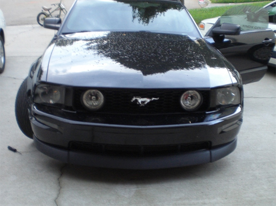

When I had my '05 it had a CDC chin spoiler...like below. I never experienced lift at any speed. Was over 100 lots of times at the drag strip and few times "in the wild".
Completely diff car aerodynamics man. Apples and oranges.
OP's car is a '08 GT/CS. My car was an '05 GT. Aerodynamics are pretty damn close. I mean the bumper cover was a little different but that's pretty much it.

I have a CDC chin spoiler on my 2010 auto + Roush M90 blower. No lift at 137 mph.
