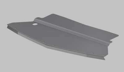

I like how I redesigned and built a front spoiler for my '08, to find Ford did it in 2010. I guess I was on the right track. Going to add that rear piece!

I would guess 5h driving distance, so not close. I already made a cardboard template but don't know how to attach it. Square rivet nuts would be nice, no idea where to get them. I think the material below the engine should be ABS 5mm thick? And it should be two sheets, one from the k-member to the radiator support and one attached to the bumper alone, similar to the Laguna Seca Boss splitter.

The plastic would have to be pretty thick and flexible. Lots of downforce created in that area. I tried to fabricate one but didn't have much luck because my air cooler sits a little low. I ended up ordering a new one from rockauto for like 30$ and modified it a little. It does help with the downforce. I don't have any lifting issues even past 150 mph (some hood shake at that speed).
