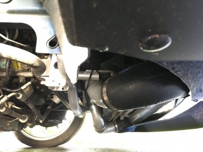

The front of our cars are like bricks in the wind so they do feel a bit lifty at high speeds.
A front splitter would help, also heard of people using the front under-tray bits from the 2010 mustang to help.
AR3Z17626A DEFLECTOR
AR3Z6C038A HEAT SHIELD
W710564S439 Retainers x4
2010 Mustang GT
"Ford says the new Mustang body yields 23 percent less aerodynamic lift at the front with a new slotted panel installed under the radiator to direct air, 50 percent better in front/rear lift balance, and has seven percent less aerodynamic drag. They tell us it is 12 percent quieter in wind noise than the outgoing car, 15 percent quieter in the case of the convertible. Ford also points to a 33 percent reduction in squeak and rattle performance, and a 10 percent improvement in speech intelligibility due to interior noise reductions, especially in the convertible"
I did similar aero improvements on my car. Gained ~1mpg in highway cruising and reduced the hood shake.
http://www.angelfire.com/my/fan/Mustang2006GT/Aero.html

This is interesting. I have been worried about my carbon hood not having hood pins. I do not want hood pins. I love the sleek look of my hood. I even bought the Aero Catch pins but have refused to install them as of yet. My car doesn't have an undertray piece. I guess the PO didn't put it back on when he installed the Procharger. My hood shakes above 70 so I wonder if I fabbed one up and installed it, would it reduce the pressure on my hood and make me worry less about the hood letting go?

Yeah, this is pretty well played out. As the dudes already nailed it.
The S197 has front end lift. Its the front, much more so than the back.
Those little rear spoilers, BTW, don't do anything. It takes a real wing in clean air to fix the rear lift.
But back to the issue of the front, which is the real problem. You can look at the progression of the factory cars for answers.
The undertray is key. Do that. Then perhaps look at a splitter like the new LS cars have.
Finally, hood venting is key. Real vents and big holes. I went with the ones from TrackSpec, and can recommend. Its a commitment, but worth it.
