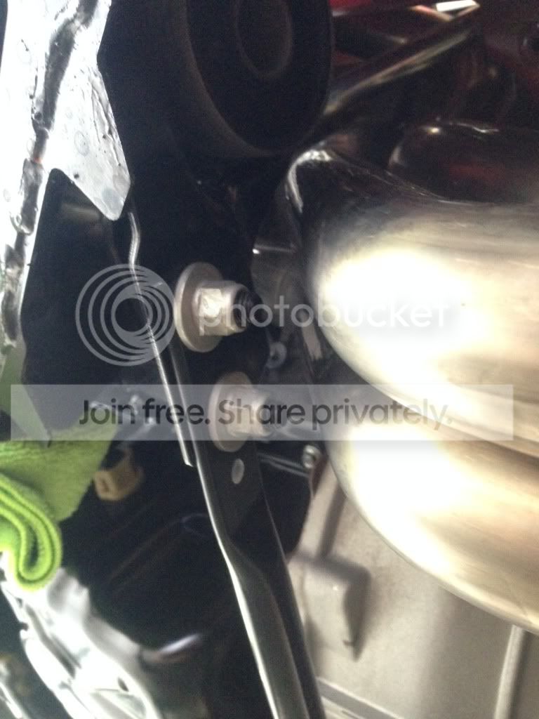

Here's what I mean on how close the headers are to the bracket mounting studs. I had put the headers on, finished every part of the install and then remembered the bracket... can't get the nuts off the studs because the headers are too close....
I just went outside and took a pic with my phone as best I could....

Exactly how mine were. I just lifted up on the tail(collector portion) of the headers enough to get the nuts on/off.
It's VERY close but they will come off. The headers flex a little.
This is EXACTLY what I describe when people want to go with the SW/SP headers and have lowered motor mounts. It would be a clearance issue. Other than that, the install was the usual PAIN IN THE FREAKIN NECK!!!!!!!!!!!!!!!! literally. LOL
Even if you have to lift up on the motor a tad by R&R'ing the (2) motor mount nuts would be worth putting that bar back on IMO.

Probably can lift the engine a bit to tilt it back.
Yea I would have put back in pretty early in the install lol.
#8 could blow and/or you could be 3V slow without it ! lol

I'll try and lift up on the collectors when I get home tonight... Although, I recall struggling with it all when I was trying to figure out how to get the frigging thing back on haha.
Holy Shit that is close!
Too close for comfort.

your best/easiest option is to simply jack the motor up a little, install the bar and youll be golden
