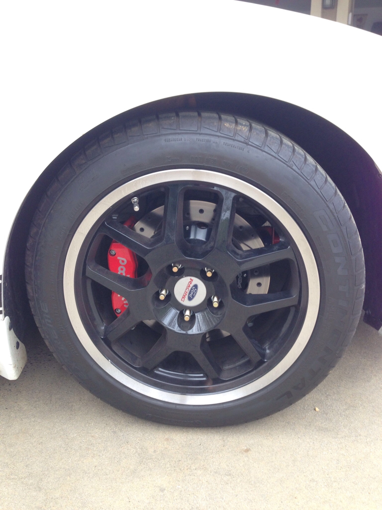

Norm Peterson
corner barstool sitter
Feb 5, 2011
3,615
326
RIP - You will be missed
Can't tell if you need a thinwall deep socket or not ↑↑↑ and the socket size required might matter just enough.
On these 1/2-20 threads, you want to be able to get at least 10 full turns of the nut (one diameter's worth of threads).
Thanks for the picture.
Norm
